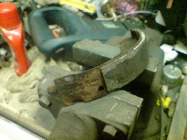

Heres the shoes....

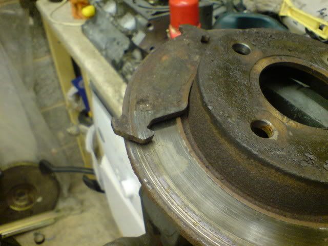

The discs and pads....

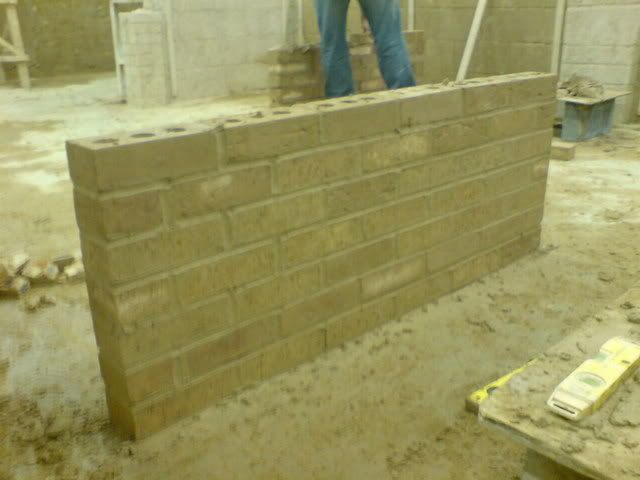

And a wall I built this evening.... ;D
Looks good :y
But Pete is getting more bricks down faster ;D

There looks to be loads of life left in those front pads!  ;D  ;D  I have to admit that I took my Omega's rear pads down to Rizla thickness. :-[
