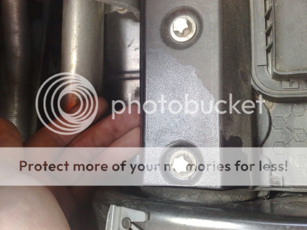

if its just the bolts showing a halo of oil similar to the pic, then may be worth re torqueing the bolts to 8nm. it cured mine, which was loose enough to undo by hand. You can see my fingers are dry of oil, which i have just run along the edge of the cam cover, so the seals had not blown with no oil found in plug wells hth
