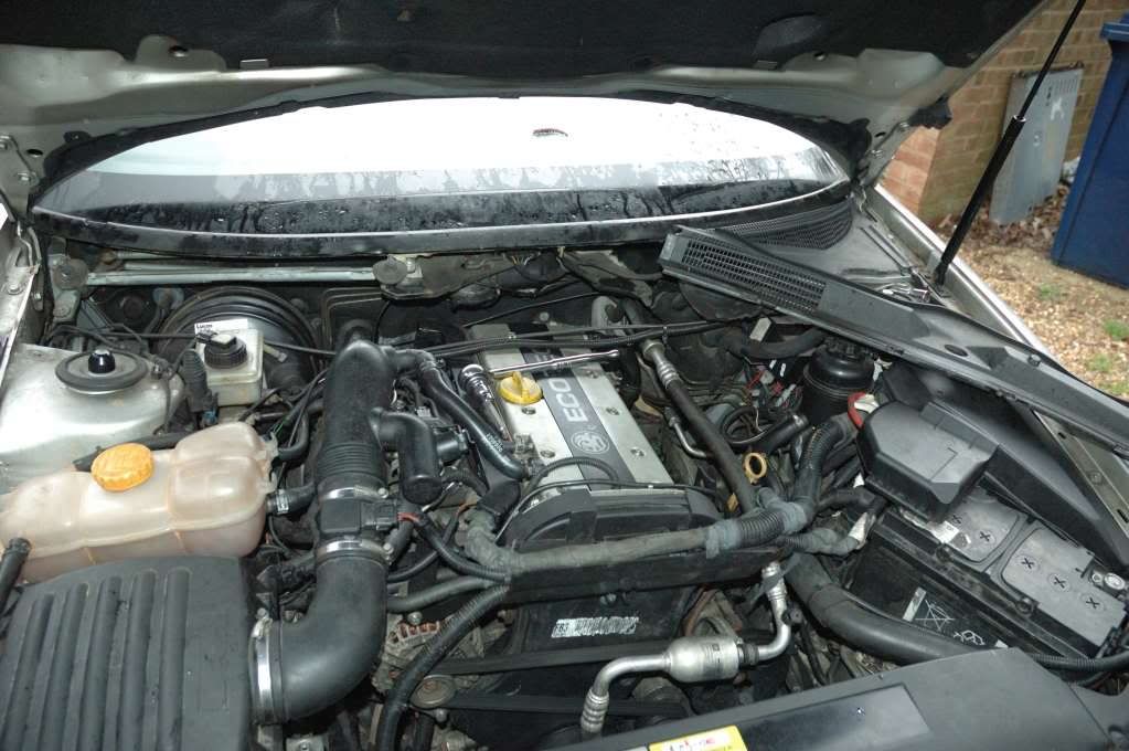

First off, remove the windscreen wipers and the scuttle to make a little more room. Make sure the engine is cold, EGR valves get damn hot.

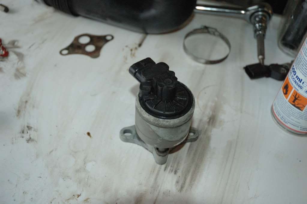

Here it is....
Here is the gasket, which i re-used and the blanking plate carefully crafted from a can of coke

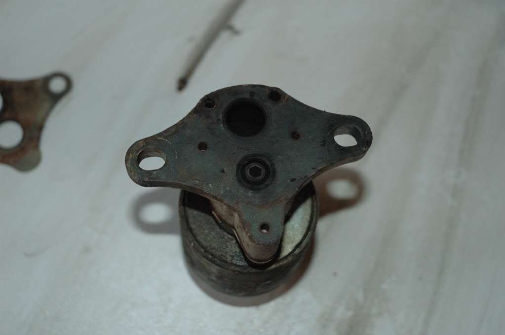

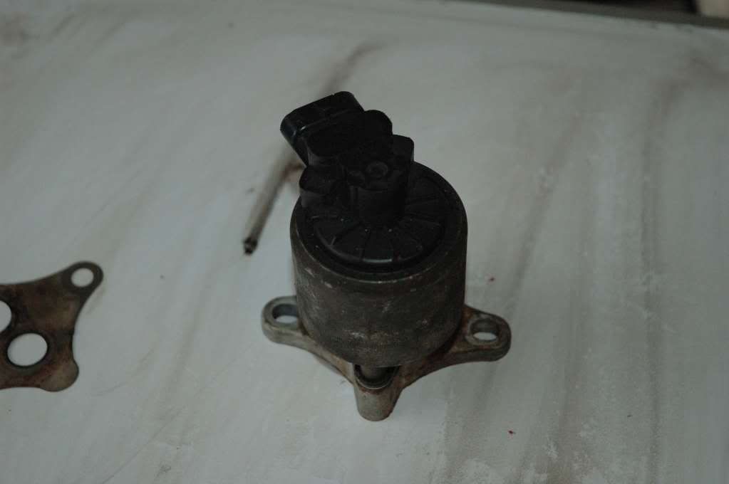

Upended so you can see how dirty it is.
After a good dunking in a jar of caustic soda for half an hour...
