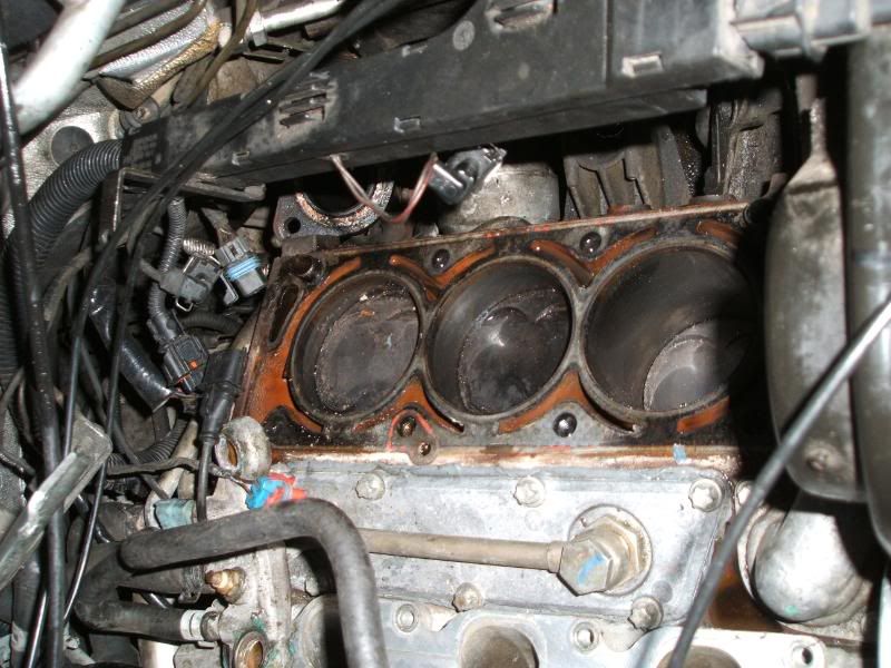

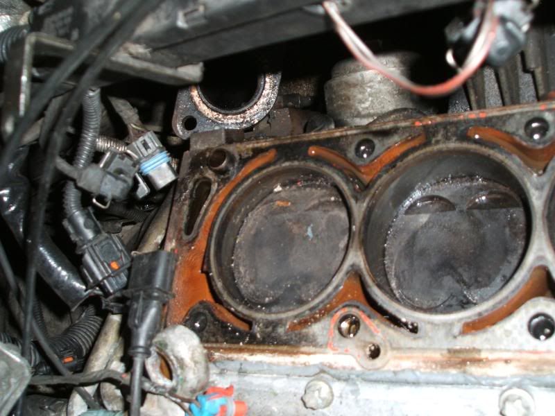

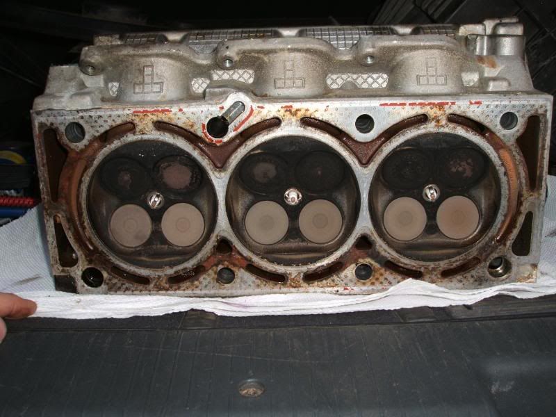

OK unfortunatly no pics of gasket as its in my brothers car!!
However please see below pics of cylinder head and engine block in current state before clean up (thats tomorrows joyfull job!!)
