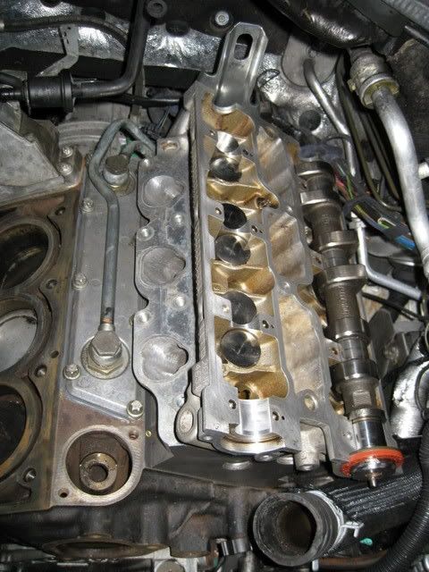

The later type can be seen here at the rear left on a bracket near the breather box

Oh dear - I had better go and have another hunt around in the shed. ::)...........looks like no electrical connections. Just one pipe in, one pipe out ?  :-/

There is an electrical connection, its obscured by the pipe in that pic (you cna just make out the cable going to it).
The bracket it fits onto  is mounted on the block.
