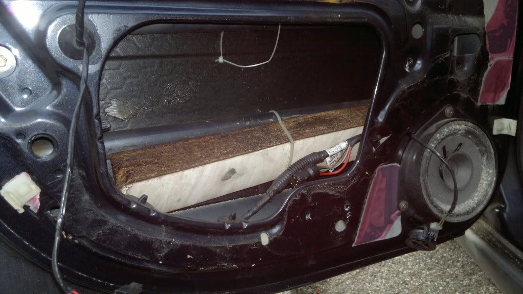

Found out what the problem is... Can you guess what it is?

Where`s the motor, can`t see any rivets :-\

wtf, someone removed motor and then propped window closed with wood and thats now fell over

well thats a new one for the book. is that setup in a manual some were? surprised it was not glued in. or some other thing holding it in place. so new motor then needed.

I was as surprised as you were! Well random!  :o
