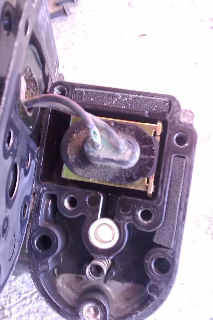

This is what I've found when took s/l compressor out and disassembled it
