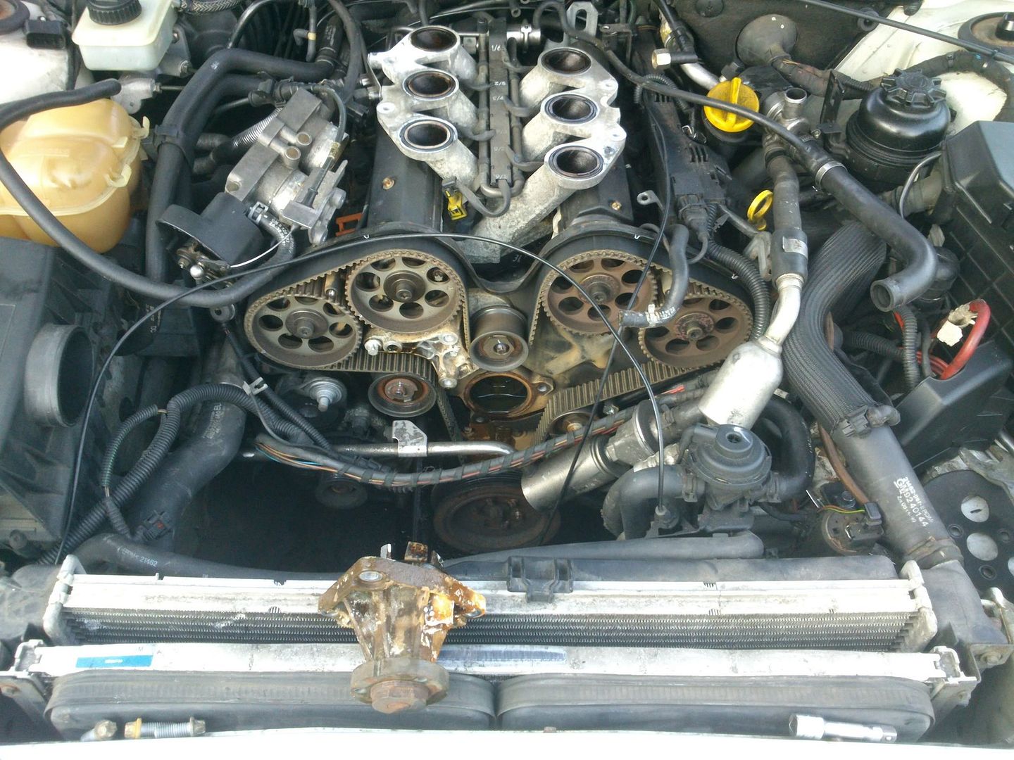

Right then...
Tonight, I thought I would tear down the front end... and this is what I found...
What a mess!!!

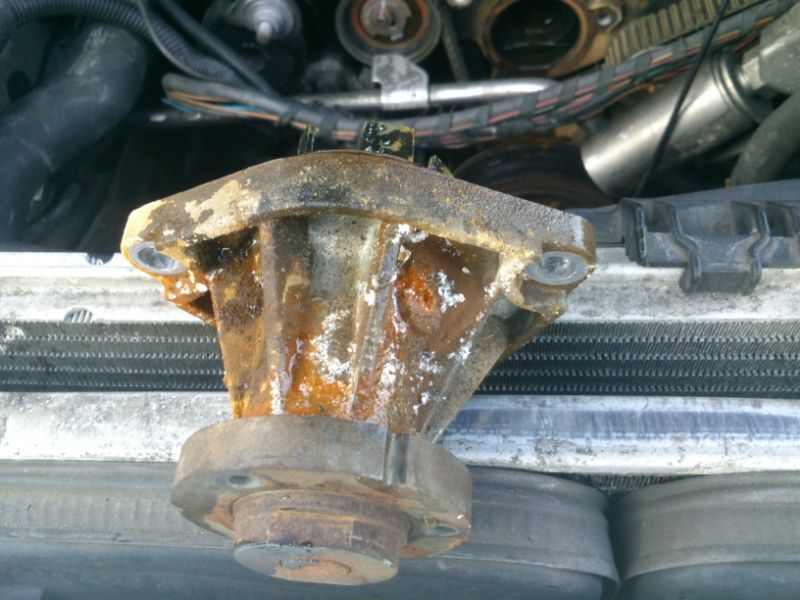

And the water pump...
Is it usual for the o-ring on the water pump to be split?
That wasn't the cause of the leak, it must've been leaking for ages, I did use some water...
Also, on the intake and vac system, I have ALOT of oil sitting about...
Is this a bad sign???
Any comments welcome as usual...

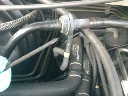

Aghhhhhhhhhhhhhhh! What size do the pics have to be??? 800x600???
anyway, here's a picture of the vac pips that's been cut by the taus belt...
