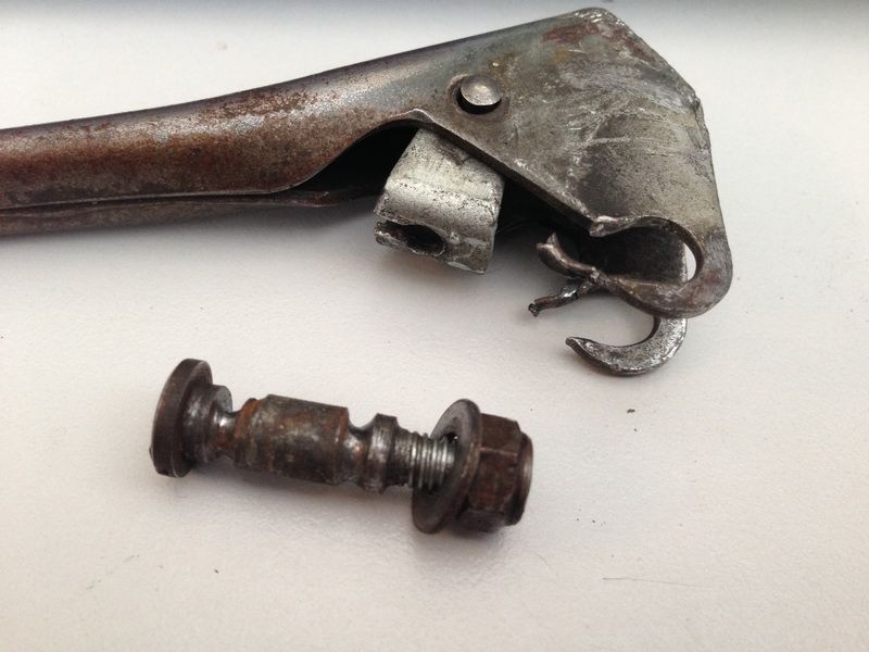

By the look of it you could probably just tease the handle apart a little and weld a couple of penny washers onto the inside to re-form the hole the hinge runs in..

Post it to me and I will do a weld reconstruction with washers to replace the worn metal  :y

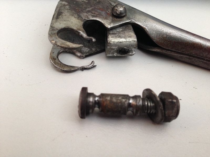

Well, normal cable, and handle came off no problem at all...
Looks like it hasnt seen a blob of grease in a long long time looking at the wear...
Any further thoughts & confirmations?
Still think this looks washer and weldable?
Definitely :y (but a short piece of tube would probably be easier to align than washers and would provide a greater wearing surface)
Worth putting a new pivot pin in at the same time....
PS on second thoughts... a stack of washers would look like a tube once welded together.

Yep, washer and weld (or tube and weld) plus a new pivot turned up in the lathe.  :y

« Reply #25 on: 19 September 2014, 14:48:39 »
The last part of the jigsaw is the fixed bracket that the pivot runs in - having seen the wear on the pivot and handle I expect the holes in the fixed bracket to be oval too :-\
  • Posts: 34140
Re: Lawn mower help
« Reply #26 on: 19 September 2014, 14:51:39 »
I would of expected there to be more wear towards out the outer ends of the pivot pin if that was the case  :y
  • Posts: 24586
Re: Lawn mower help
« Reply #27 on: 19 September 2014, 14:54:09 »
The remainder of the bracket is sound. Looked round to me
Cheers for the offer Mark. Will be in the post shortly ta
