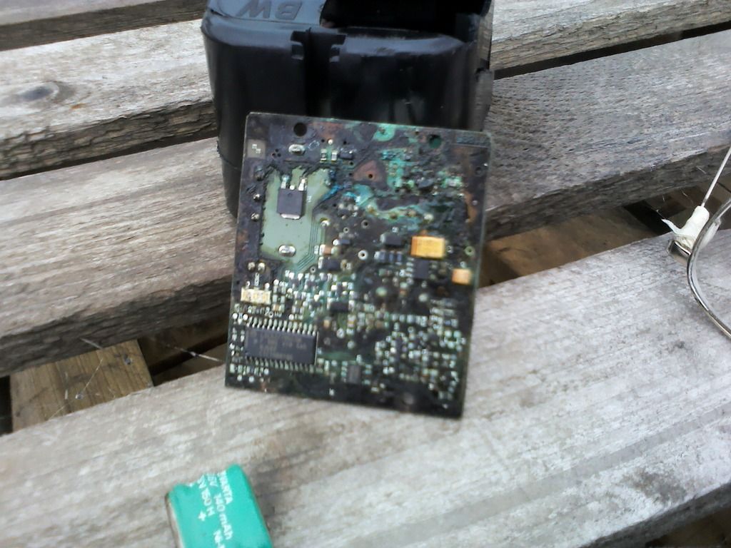

Thanks for your reply, it goes in behind the wheelarch liner, I connected it back together using a connector block thingy and wrapped in insulation tape, think it may be the feed for the side indicator repeater.....at least it is safe now to leave the battery connected, I smashed open the removed powersounder and the circuit board was black,

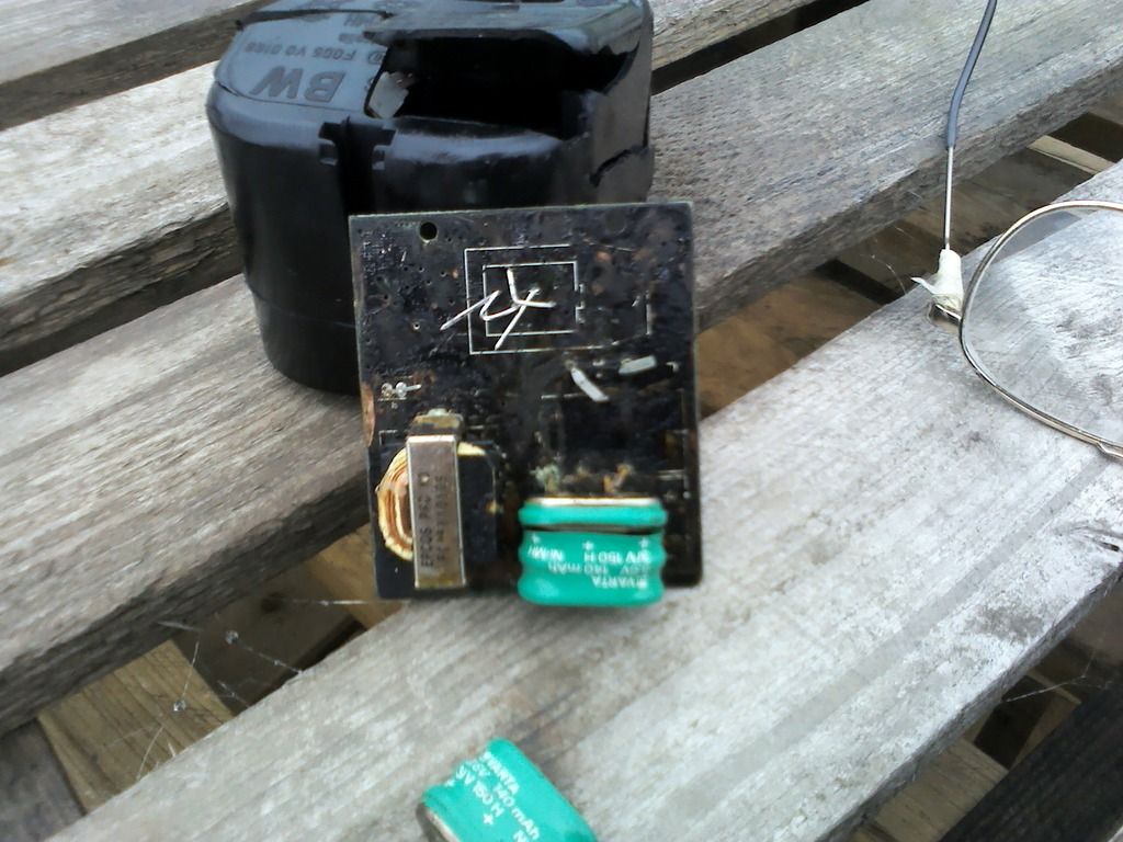

Happy now it is out, out of interest I read on here that it shorts across the car battery, would it do the same to the alternator, mine died after 2 days, ie do power sounders kill alternators??
Some pics hopefully:
