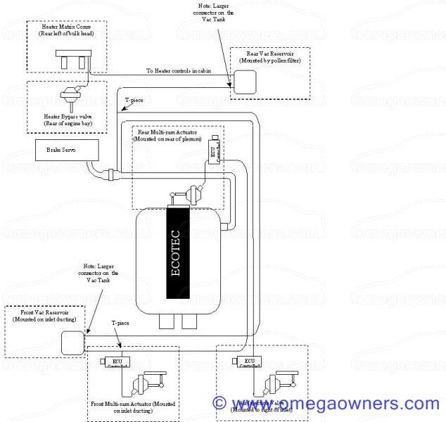

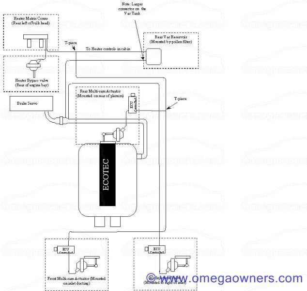

or later cars...
Hi i take it my set up is the first one.Been out today to see if i can spot anything,but i may as well be looking up a ducks arse. ;D :D A kind member on here has offered me a set of vac pipes,but from a later car 3ltr x reg i think.My concern's are will this set up have all the pipes i need,it may well have missing the ones i need.Also if the car was idling and running correctly before fitting the hbv,would that not suggest.The vac set up was ok and that i have,disturbed,broken or not fitted something correctly.Also it has been suggested i unplug the MAF,but if it is faulty would it run both rough at idle and when driving.Hope that makes sense,if not feel free to tel me.Any info much appreciated Dean :y
