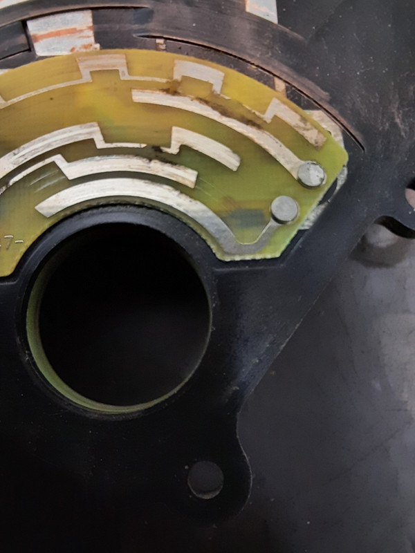

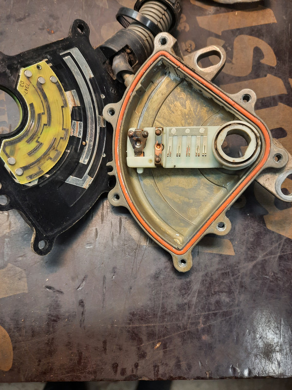

polilara
  • Finland
  • Posts: 1138
    • 2.6 Y26SE Elegance 2001
Re: Auto-box faults & lights flashing
« Reply #3 on: 20 February 2021, 19:24:18 »
Mine needed totally new one as two of those thin metal leads were broken. Those "printed cards" maybe cannot be bought.

polilara
  • Finland
  • Posts: 1138
« Reply #5 on: 21 February 2021, 12:50:14 »
What a list... good to keep for spares anyhow.
I studied this selector case a bit more, those cards might be available somewhere, found from Russia "Opel Omega Club" -pages one article having a card which seems to be soldered there afterwards as a spare. It has nice copper leads. Problem is that I do not understand this language. Price of new original selector in Germany is 450 euro so repairing those would be a solution. Changing the card is simple, just solder 5 leads.

dave the builder
  • Derbyshire
  • Posts: 7895
    • omega b2 2.6 cdxi
« Reply #6 on: 21 February 2021, 15:04:53 »
I think the site talks of re printing the PCB to replace the worn or damaged tracks .
quite a specialised process .
some very helpful pictures from you polilara and also on the RU site for future reference though  :)
