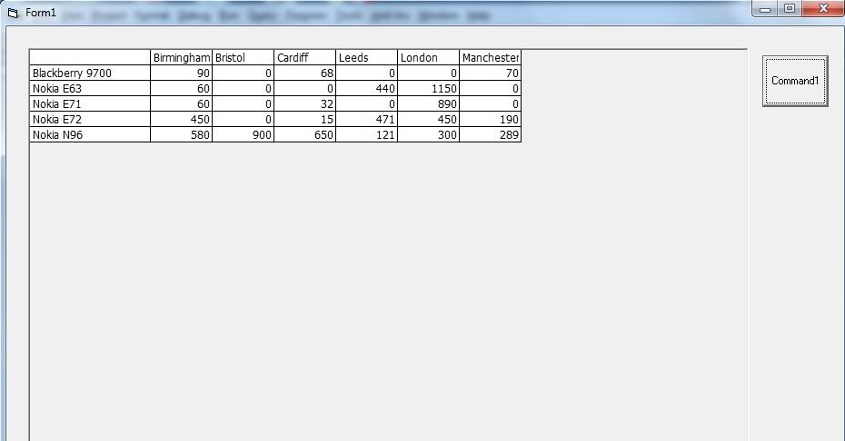

code for pivoting

and here is how the actual grid looks with some test data
if you need I can supply also a code that you can transfer the pivoted table to excel also which will be helpful for printing purposes..
