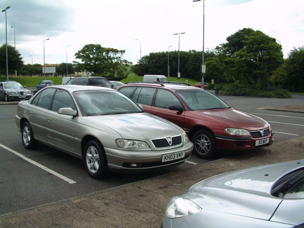

Stopped off at Hartshead Moor Services on the way back......Runs like a dream..... :y :y :y
Only problem, a new battery was put on it for it's MOT and since then the air bag light is on, typical Omega more lights than a Christmas Tree, any idea's how to switch it off.... ::) ::)

Hmm, I can't really think why the airbag light would come on if the battery had been disconnected. I've had to change plenty of batteries on Omega's and that alone has never caused the airbag light to come on. If the door loom, or front seats had to be touched then that could cause the airbag light to come on.
A tech2 will clear the airbag light, but an external device is needed, there's nothing you can do yourself to clear the light.

change of battery won't cause airbag light to come on, means there is a fault someware in the system, or at some point one of the sensors have been un-plugged. Needs a chat with tech2 to resolve  :y

seriously, if the car has been over enthusiastically valeted, then it is possible that the seat wiring has been disturbed whilst hoovering. had this happen afew times with vectra cs. :-/
i know the wiring lives under a cover at the side of the seat, but this does pull off quite easily.
