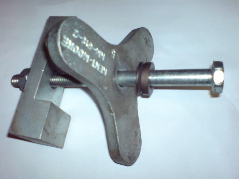

haynes also covers procedure, and shows a diag. of special tools for fitting and removal. May give further ideas, but i found the puller method as the guide, to work. Hope the pics are clear enough to give the idea.

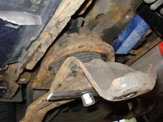

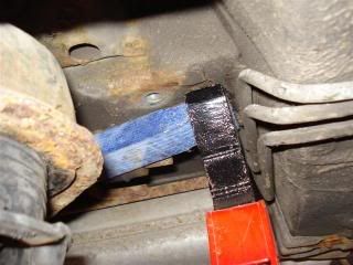

I managed one side tonight. Here are my notes for others comtemplating the job.
First point is ignore Mr Haynes. There is no need to drop the exhaust and do not support the car on the ribbed floorpan as it suggests. I really struggled to find a good place to support the car away from the suspension because you need the suspension to be hanging.  So jack the car on the trailing arm high enough to get the axle stand in here on a wood block. No need to remove the road wheel

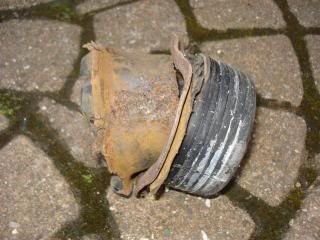

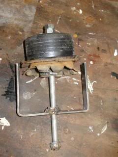

Next remove the triangle shapped plate and the big bolt through the middle of the bush. Leveraging out the bush was totally impossible so I made this tool

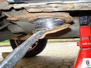

using some bent steel, threaded rod and welded on some nuts. It pulled the rubber insert out no trouble but left the steel surround still in place. After much banging and leveraging it barely moved so I took an angle grinder to it to create a slot into which I could lever a crow bar. It finally came out.
This bush was dated 1999 so it was the original and had done the car for 185,000 miles.
