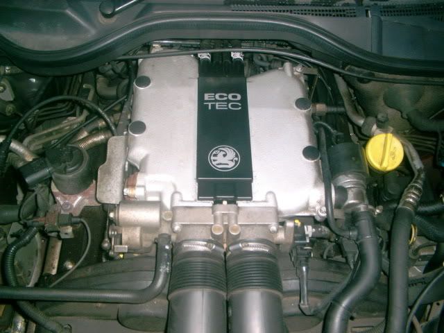

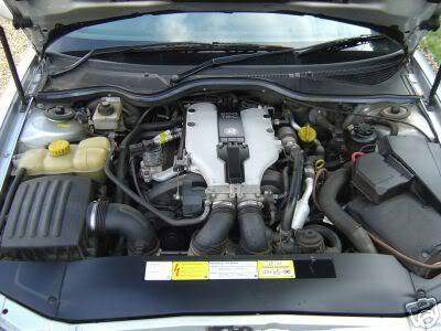

Am I right in thinking that a 3.0 has the extended plenum. Below are 2 pics one is 2.5 the other a 3.0. Can anybody confirm the extended plenum or if I have misunderstood something?

The earlier 3.0 model had the short Plenum too :y

Great thanks. It did have a sticker with x30xe

Extended plenum on mini facelift 3.0l (mid 97 on), not on 2.5 as 2.5 is better with smaller one.  2.6/3.2 have extended plenums, although the 2.6 would be better off with shorter one but no room for throttle servos on shorter one.

Those are both the same (short/original version) (I think..?)  The extended plenum is significantly different and I think the black plastic bit comes in separate sections.  I'm sure someone can post a pic.
