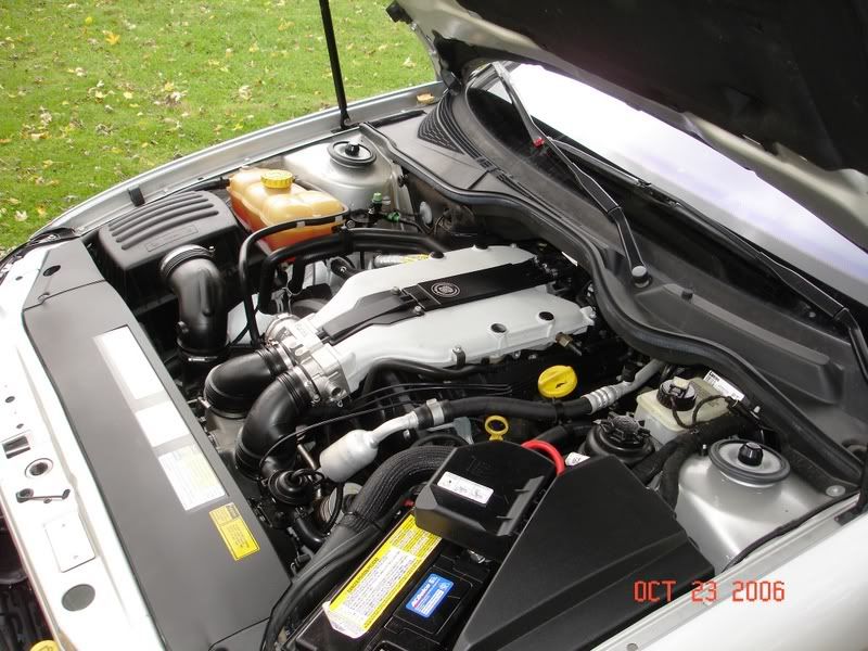

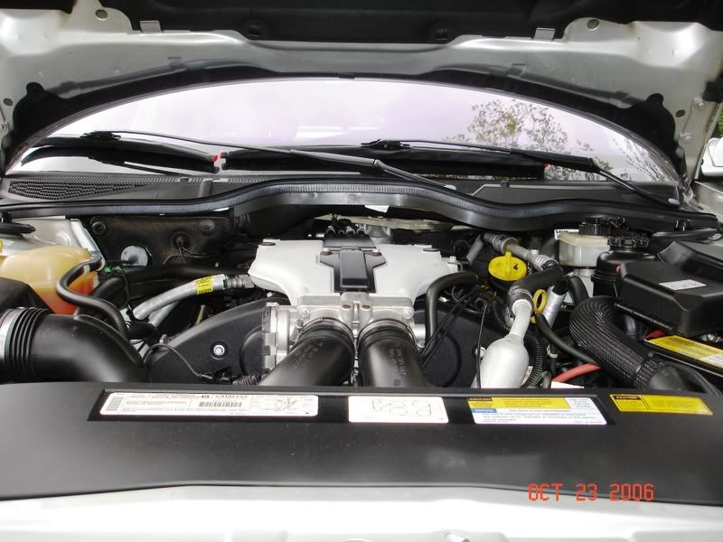

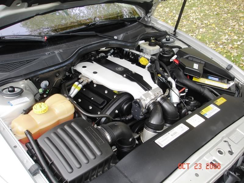

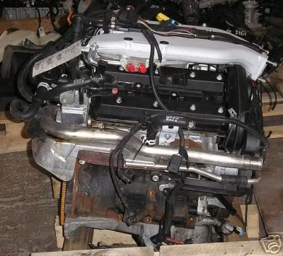

Well I decided to post up some engine pictures.  These are from about a year ago when i got her... mind you that engine had 60K miles on it... and it was clean as hell... today its got over 85 and it looks the same... and maybe even cleaner...  ::) I will post some pictures for comparison later..
That engine put down 195hp at the rear wheels...

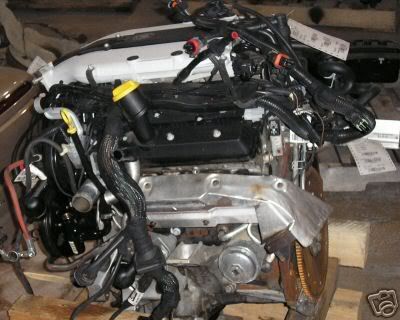

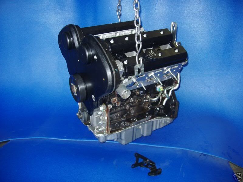

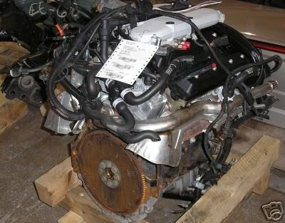

These are from the 3.0L but they are not mine... found them on some random site...
These are from an engine that was removed from another catera... and it was fro sale on ebay... figured someone can use these pics to figure out where stuff is...  Hope it helps...

coil packs and FBW on a 3.0  :o
Thats America for ya

I thought it had something to do with the coil packs... as I think all 2000-up models have the DIS... Distributor-less Ignition System.... or as some people call it Coil on Plug design.
The DBW is kinda nice as it adapts to your driving style so it helps with the throttle control, the only thing I hate is the fact that it takes full control under zero traction conditions..  Another nice thing is the cruise control has no additional components so its virtually fault free and your gas pedal dose not float as the old systems... it just sits there at the highest position.

Two things being confuddled slightly...
DBW variants have the coilpacks spread over the plugs with no High Tension leads supplying the electricity for a spark.
UK, cable throttle variants have a DISpack on the rear of the block, still without a standard 'distributor' but do have HT leads supplying the sparks.
Check out some of the engine piccys on here to see the differences.....   :y
