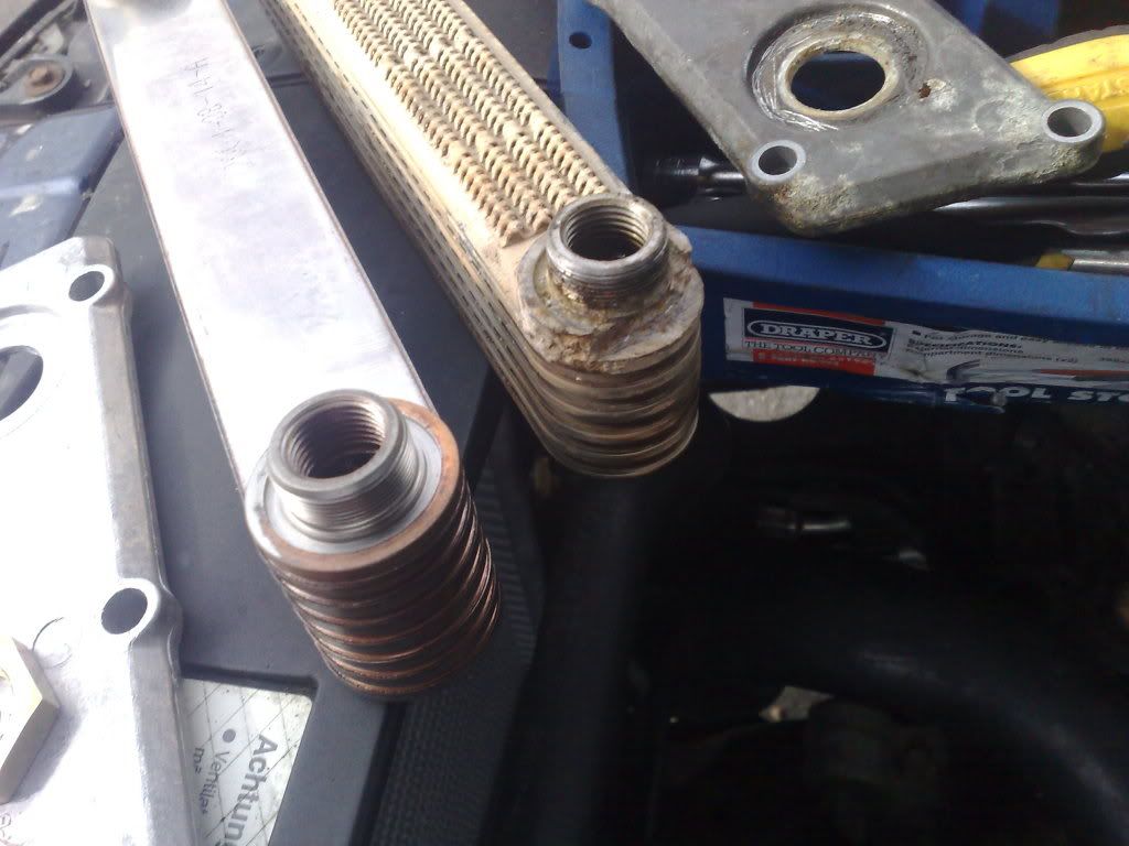

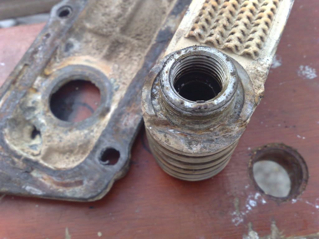

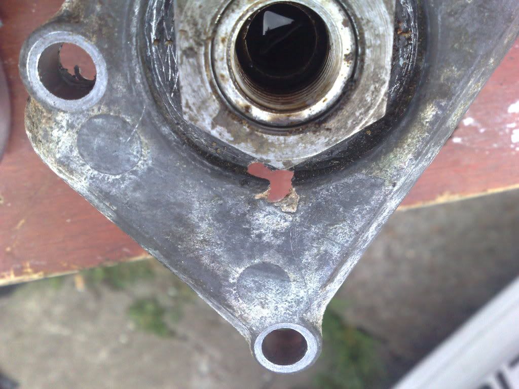

right, after a crap weekend with everything going wrong i got back to to Omega, the oil cooler cover plate was eaten through by corrosion and its available from the main dealer, when i removed it from cooler i found that was eaten away too so the whole thing is being replaced at a cost of £120+vat

Got a brand new oil cooler in too, the old one being eaten alive by corrosion on the actual rad and cover plate which i assumed was down to lack of antifreeze (corrosion inhibitor) BUT i  think its down to crap quality materials, ally ect as much many other parts of the engine are in really quitre good nick, the water pump and impellors espesially look brand new!!

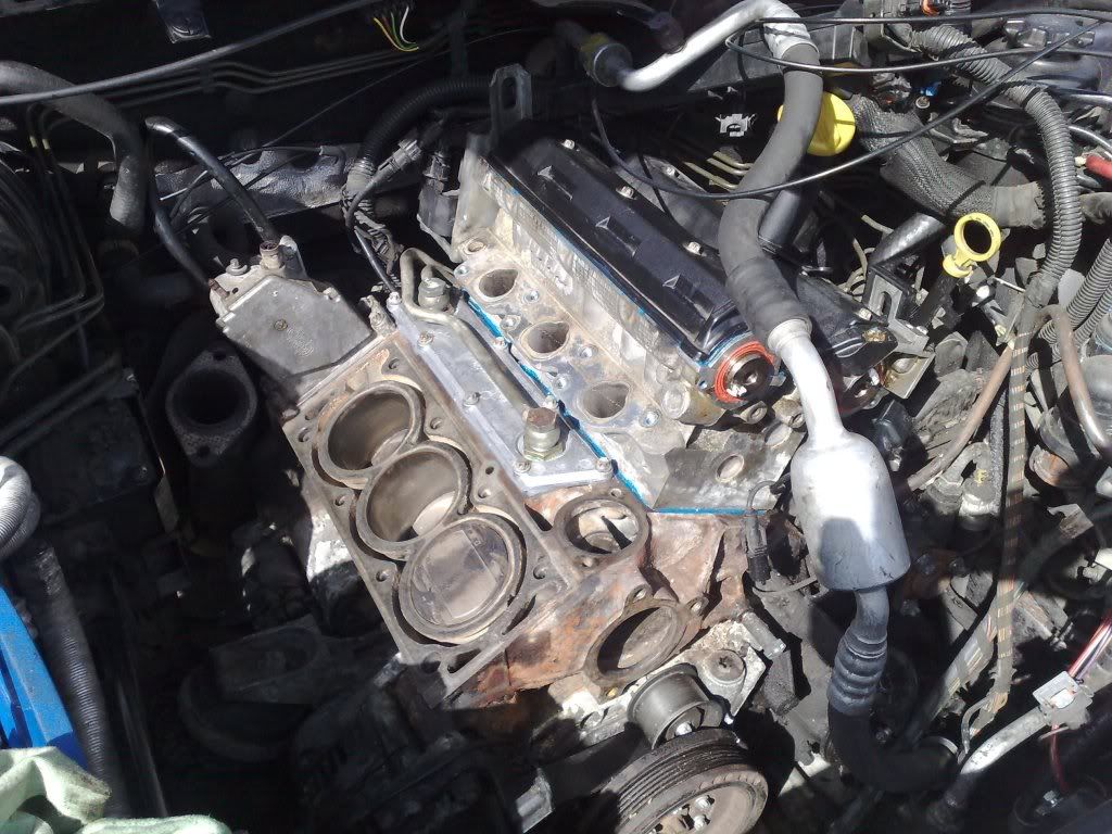

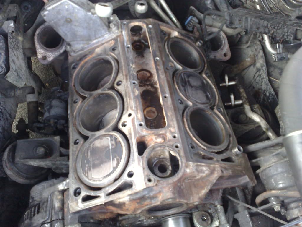

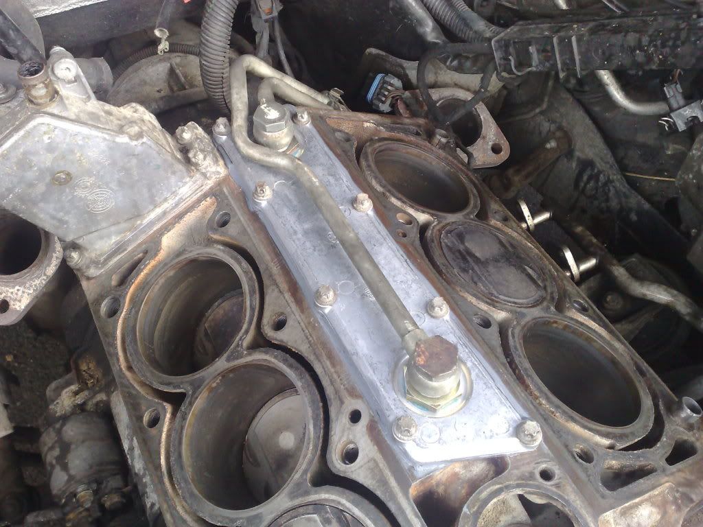

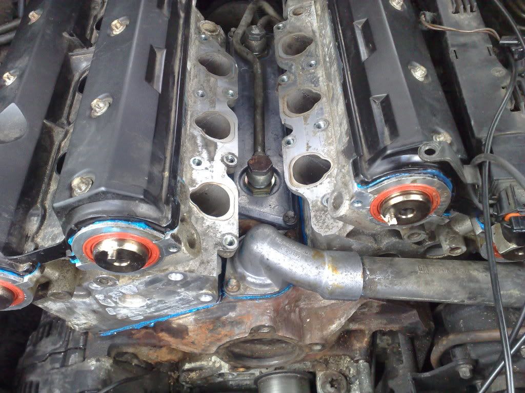

At last got some pics (laptop problems) the oil cooler had seen better days (as previously mentioned)
And i no what yout thinking "gasket sealer on a head gasket" ??  well yes and no i put some just around the outside edge as there was evidence of water loss through it in the past in quite a few places around both heads! it didnt go no where near the fire rings!

Martin_1962
Re: Suspect head gaskets?
« Reply #21 on: 27 August 2009, 20:12:48 »
One bit of advice - refit 135 first and 246 afterwards easier to get to the coolant pipe
« Reply #22 on: 27 August 2009, 20:17:59 »
Looks like he,s already fitted both of them. ::)
