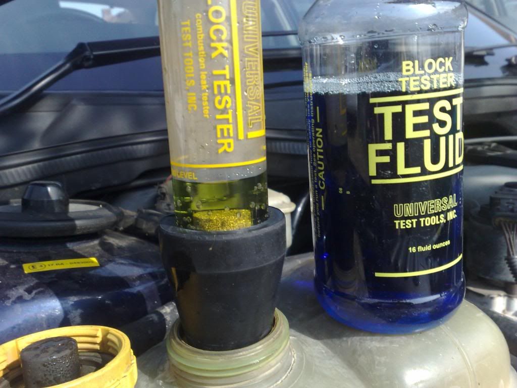

2.5 V6, when on M25 white smoke from exhaust when throttle pressed, got home with a misfire and temperasture spiked but not too high.
loads of mayo under oil cap BUT sniff test proves negative!! unless i been sold blue water, lol
oh and bubbles from expansion bottle too but sniff test liquid stays blue!!!!!
What do we think? im gonna strip it tomorrow as it needed for the weekend.....

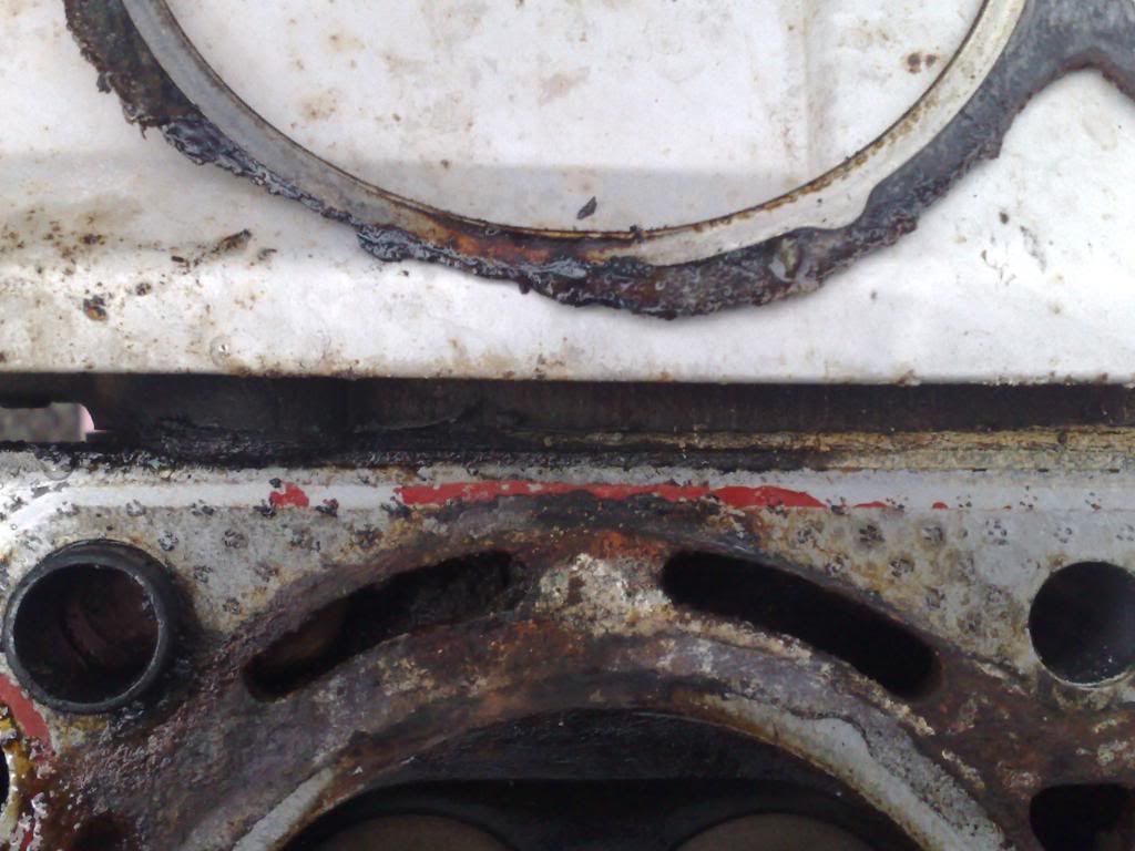

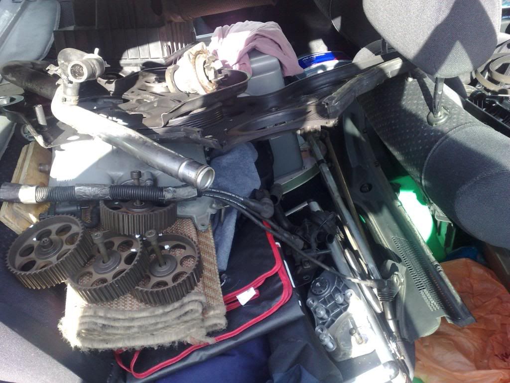

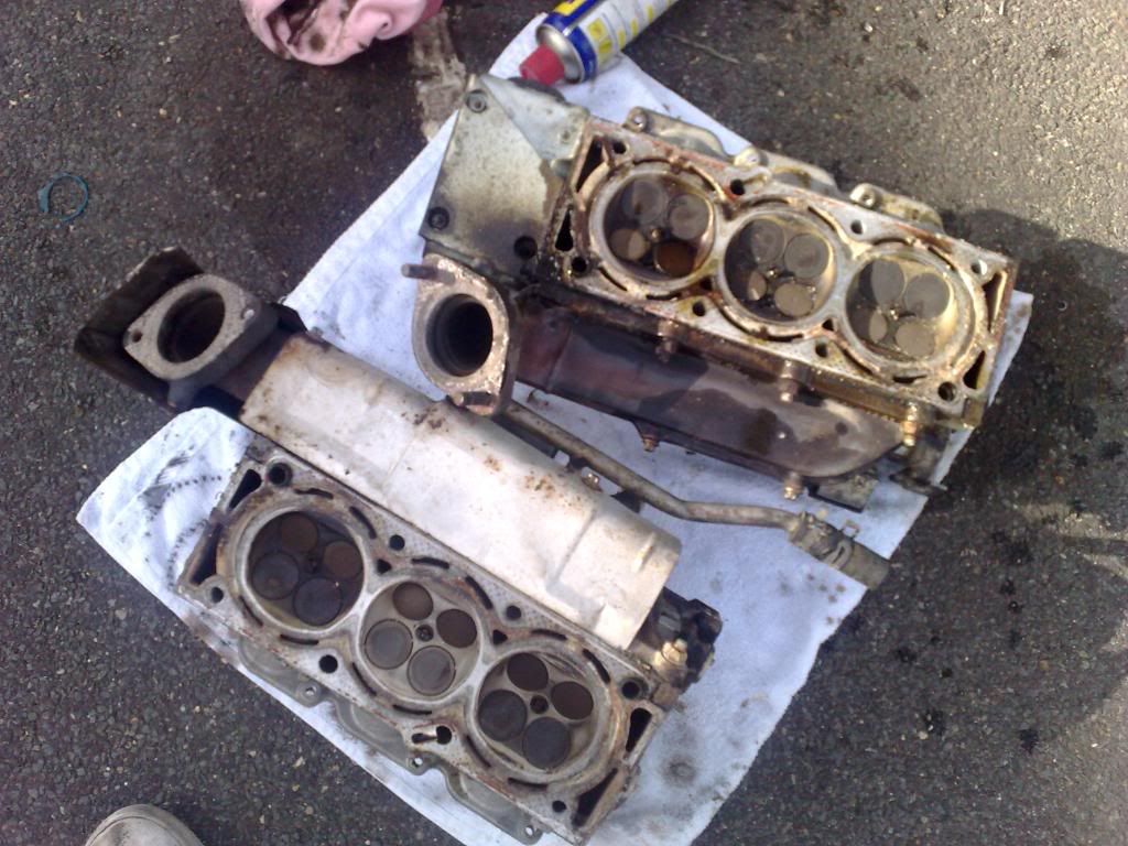

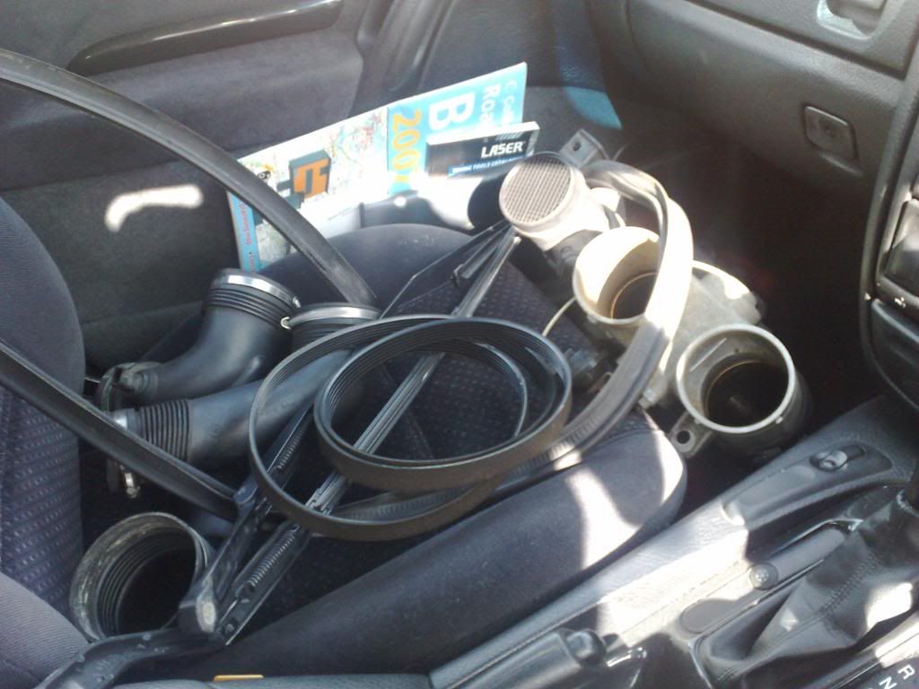

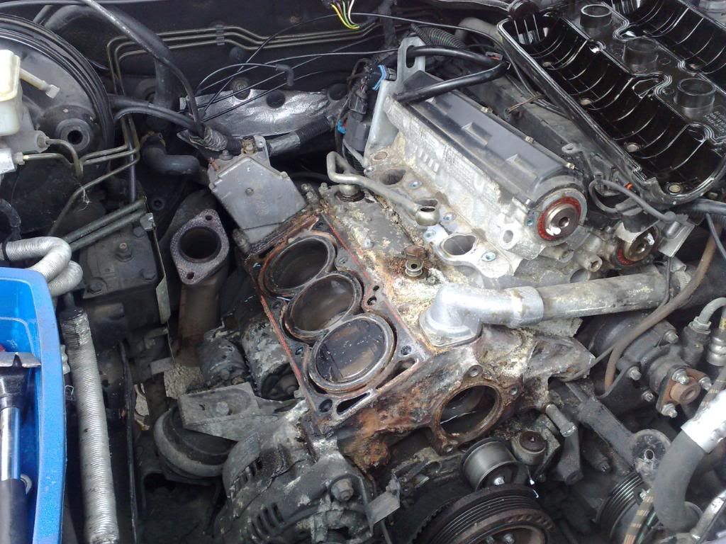

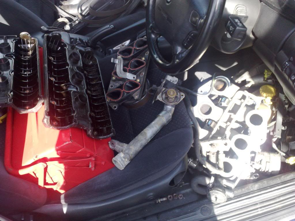

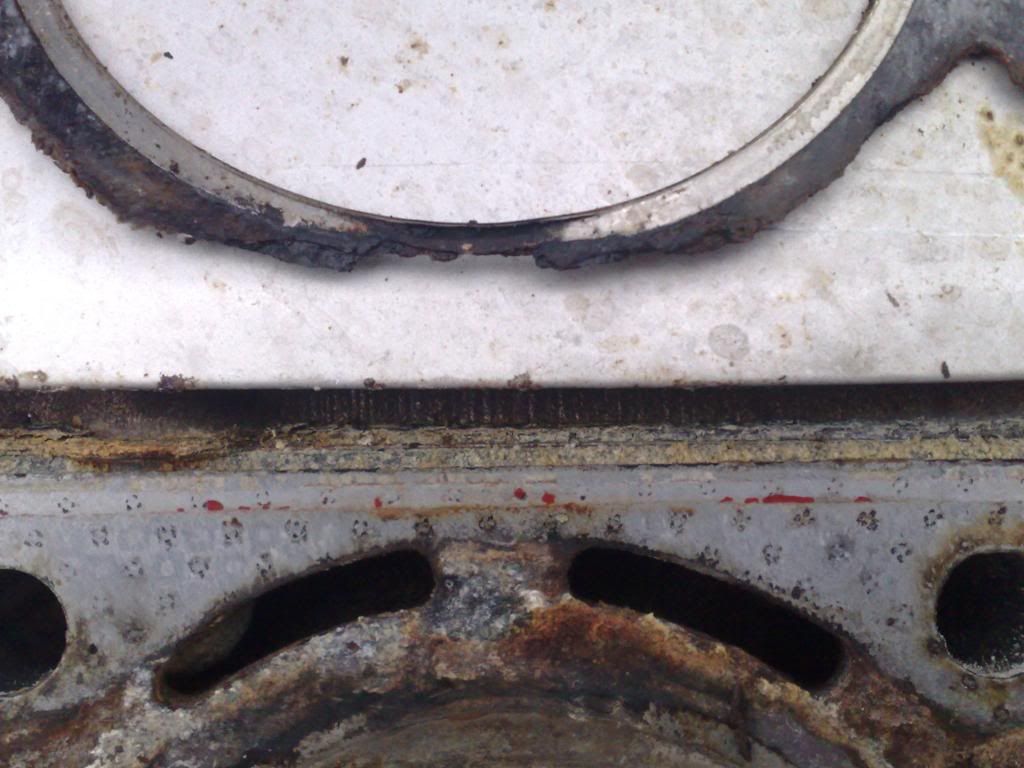

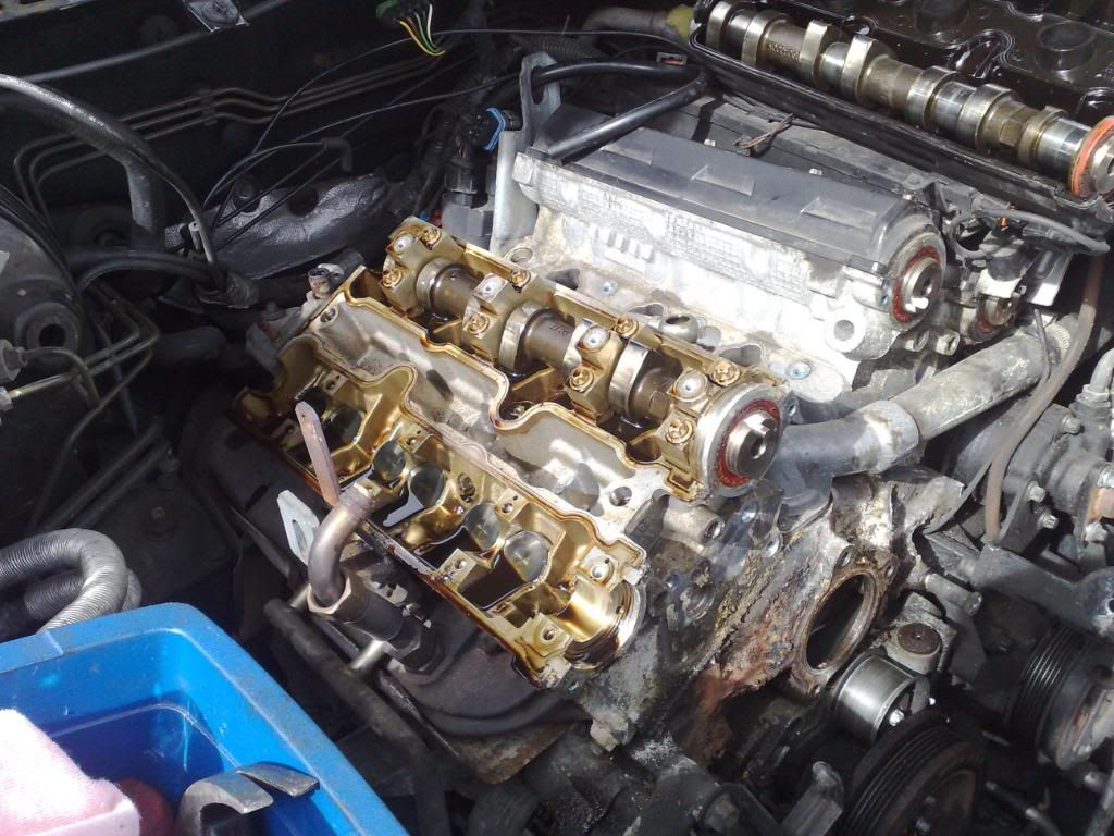

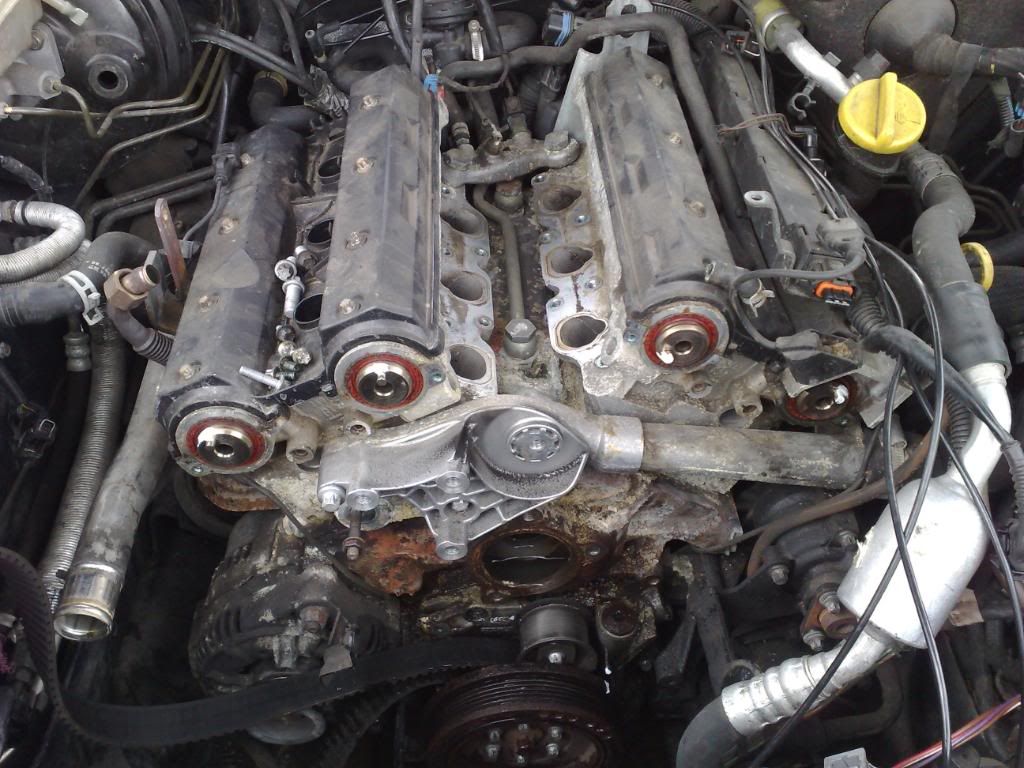

« Reply #12 on: 20 August 2009, 22:23:56 »
What a **** of a job! oh my god it was horrid but hopefully refitting will be better, it usually is..
One cam from each head had to come out to get to head bolts!
Its defo head gasket on two cylinders of this head!
There both off, 7 hours! bloody horrid job!
But my god the crap i have removed to get to this point?
Toyota Supra 7MGTE head gaskets are positively simple to do after these!!!

« Reply #13 on: 21 August 2009, 09:27:40 »
Might be worth removing and re-sealing the oil cooler and thermostat while you're there. Looks like something has been making a mess down in the middle of the vee.
Glad the diagnosis was correct.

Oh jesus, hope mine aint like that!
where can i get that "do it yourself" test kit to test my coolant tank to see if it changes colour, indicating my head gaskets gone?
