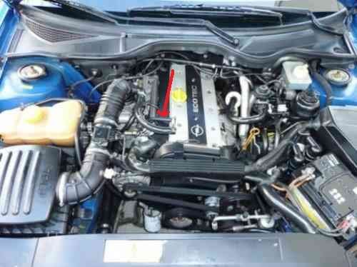

no its this pipe with the arrow. no mater what oil is used it all ways blocks up at the end of the pipe where the hot water gose round on the case of the air intake. :y
Thats one :o - never seen anything on that before
How often do you clean that one out? I'd be cleaning that annually.

« Reply #12 on: 10 October 2009, 16:06:54 »
every 2weeks or so, its not the pipe its the heat ring keeps blocking up had it to bits b4 and there is a heat ring the pipe gose in the middle then into the air intake, aways blocks up at the heat ring.
