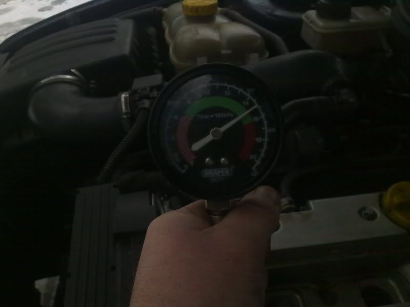

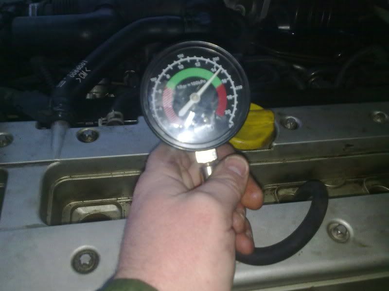

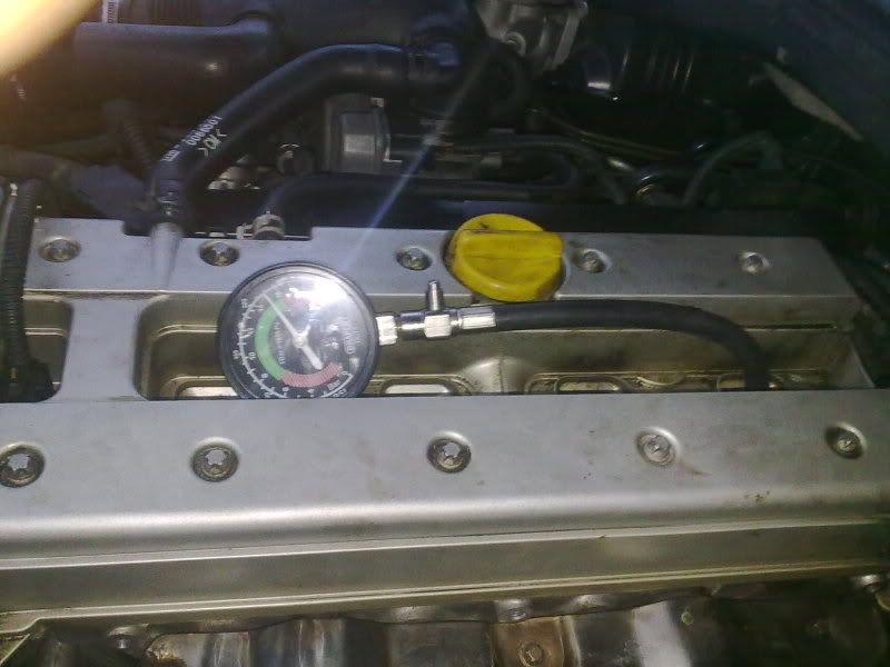

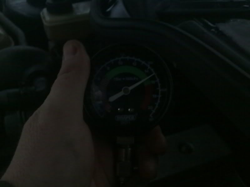

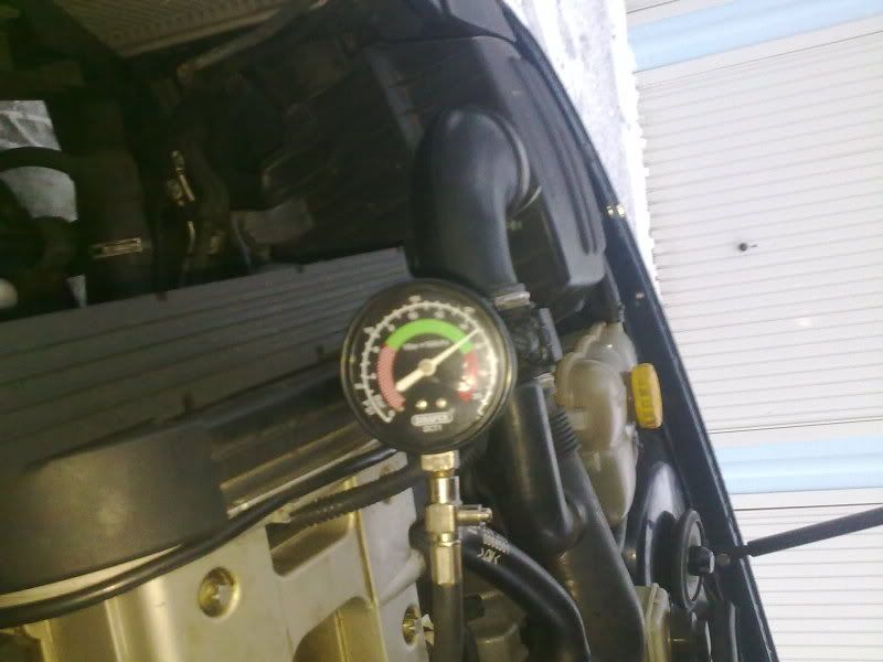

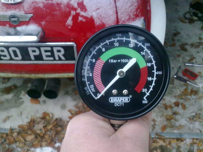

right after the reply to the thread saying even with that much mayo does not mean its the hg could just be short journeys and to no for sure i need to do the comp test!
got all my warm kit on again and went to do it
this is my tester (you will no better than me,wot the readings should be and also bars or psi)
right all plugs out,and electrics disconneted
pot 1
pot 2
pot 3
and the dreaded pot 4
can see it better here
 :-? :-? :-? :-? :-? :-? :-? :-? :-? :-/ :-/ :-/ :o :o :o :o :o
they all look the same to me !!!!!! is the pressure on all pots what it should be ????????

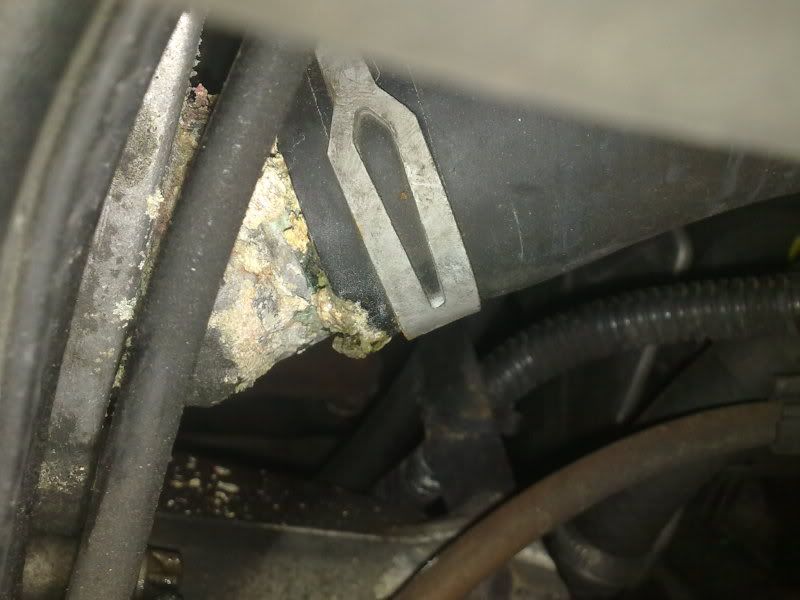

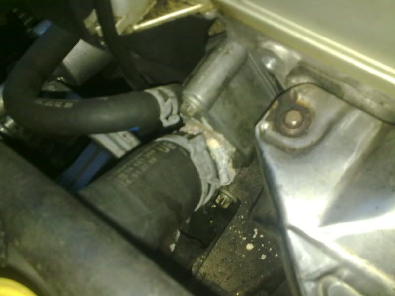

but i did also find this,could this have some thing to do with it?????
i noticed that the curd stuff is WET!

as long as they are all the same, thats good news! Checked the HBV?

also seeing the comp on all 4 pots are the same at 15bar what could the bubbling in the header tank i was getting be???
the pipe from top of rad going to thermostat seems to get very hard with presure as well  :o could the thermostste be blocked/not opening because of all that crud i showed in the pictures? also could that be where the coolant is leaking from

What temperature was the engine when you did the above compression test?
I'm thinking you may need to do it both cold and hot, as if it is a fire-ring leak, it may only leak detectably at some temperatures, due to thermal expansion differentials.
I prefer the simple test of running the engine up to temperature, leaving it to cool back down for a few hours, then looking down the sparkplug holes with the aid of a bright little torch.  If there's coolant sitting on any of the piston crowns, you have a HG problem. If there isn't, you probably haven't.
Do the bubbles in the expansion tank smell of fuel or exhaust fumes?

yes the bubbles did smell of exhaust ,and the exhaust its self seems to be kicking lots of steam out, as for comp test the engine was at normal running temp
but now the bubbles in the header seem to have stopped  :-/
i thought the bubbles prob ment hgf esp with the mayo in the pipes as well ,but would the comp test not shown this up???

Hi Griff, firstly yes you do have a longstanding coolant leak from the thermostat hose, so drain off the coolant via the radiator drain plug (round red knurled handle on bottom right hand side of rad, can be seen by looking up from beneath the front bumper). If the coolant is new or very recent, then drain it in a clean dish for re-use. Remove the offending hose from the thermostat housing, push a clean rag into the hole to stop any crap getting in there & scrape off the crud & rub down with emery cloth or sand paper, little bit of lubricant & back on with the  hose. Refill the system with coolant (should be a 50/50 mix) & run the engine up to temperature with the expansion bottle top off, 'burping' the coolant hoses (top & bottom hose) several times as the engine gets to temperature, then refit the expansion bottle cap & keep an eye on the coolant level in the bottle for a few days. You may need to 'burp' the hoses a few more times over a couple of days.
Secondly, from my experience the bubbles in the expansion tank are an early indicator that the head gasket is failing & this is undoubtedly due to poor coolant maintenance in the past. If yours does as mine did, then the next thing will be rough running at cold startup with very noticeable coolant loss & clouds of water vapour out of the exhaust  :(
