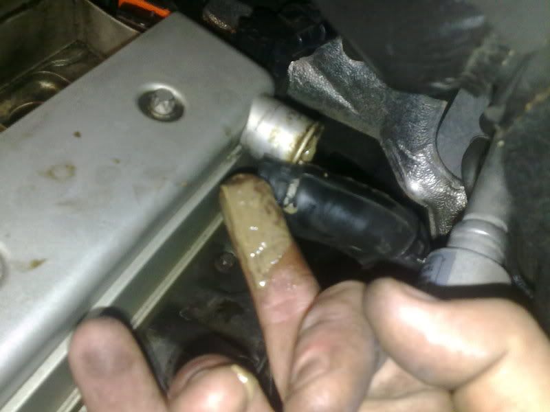

yep your all correct :-( hg def def gone!!!!
went out for a hr to garage today ,was going to check the compression,but thought if i checked the breather pipes first before i did that ,that would also give me a good idea if the hg had gone
this is what i found :-(
top pipe that goes from rocker cover to the air intake

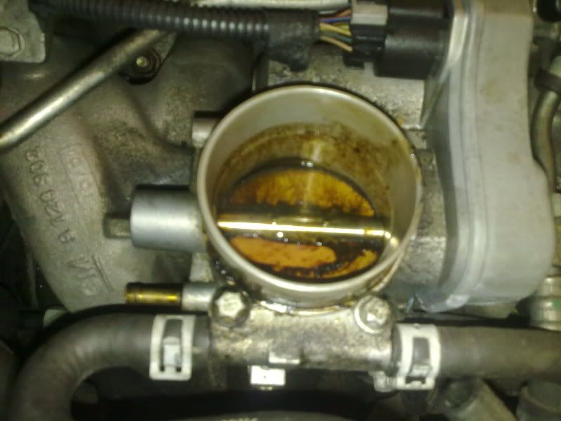

as you can see mayo every where  >:( :(
so next the tb
thank god no mayo but its def in sh.t state :-(
(when i do the gasket i will get the carb cleaner on it)

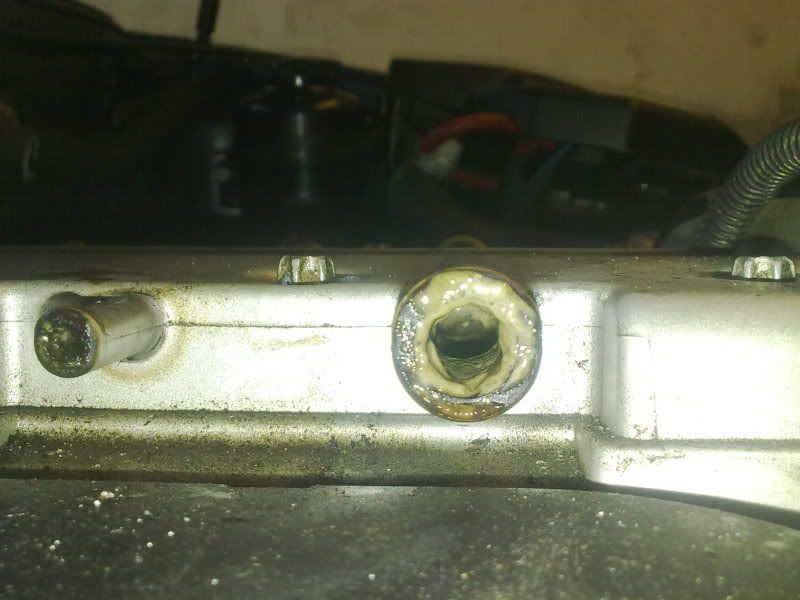

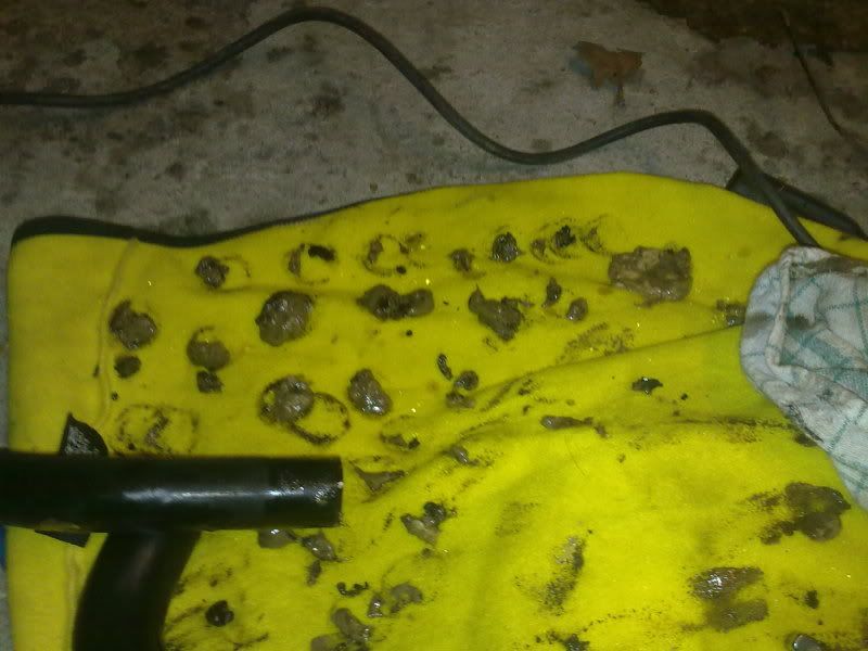

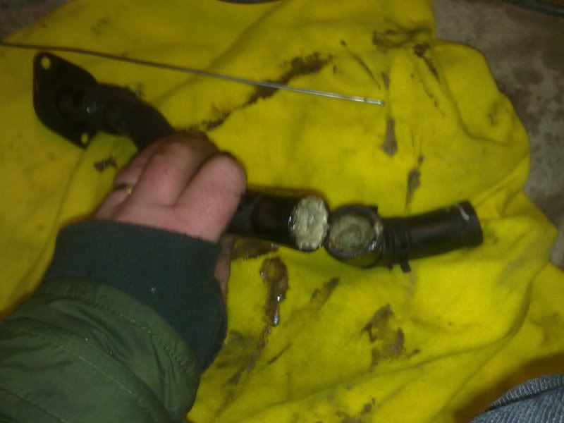

next was the main oil breather  >:(
 :(never seen so much mayo ! and im a chef!!!!!!! pmsl
very strange though as still no mayo in the header,oil filler neck nore on the dip stick
  • Posts: 37651
Re: quick question
« Reply #13 on: 05 December 2010, 13:42:47 »
actually thats not bad, in fact its normal for short runs! Don't just go on that just for HG. Condensation forms in those pipes, mixed with oil turns to mayo.
To check if it really is HG, do a compression test  :y
