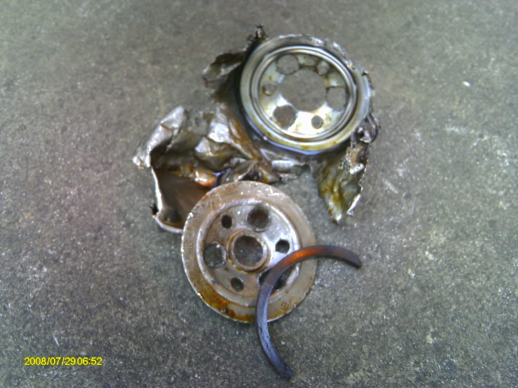

Yes!!!!!!!!!!!!!!!!!!!! , despite what I said in my last post I decided to go and have one last go at getting the bugger off.
A hundred more swear word's and 50 more bang's to my hand and forearm later and the bloody thing is off.
I got a torx 45 socket and hammered it into one of the filter holes and then attached an extention bar which I used as a handle.
I also cut away some of the rubber seal with a stanley knife which helped a lot.
So my Oil change which started at about 11.00am yesterday finally got finished today at about 6.00pm ::) ::)
My car is now filled up with lovely new Mobil 2000 semi-symthetic.
I made sure I filled the new filter halfway up with the new oil and oiled the rubber trim before attaching as suggested by tunnie.
THIS IS WHAT MY OLD FILTER LOOKED LIKE ONCE FINALLY REMOVED
http://i1097.photobucket.com/albums/g357/eliciumpreview/Omega/OilFilter001.jpg
What a bloody drama!! :D :D :D :D
Similar to mine but in more bits ;D ;D ;D
