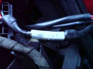

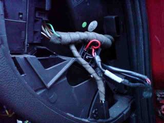

Thought I'd post some Pics of the of the two little culprits, The rear fog lamp wiring (Blue/Black) was intercepted by an additional pair Blue/Yellow and another thicker Blue/Black, which can now be seen discounted and hanging down in Pic 2, they were connected and hidden within the wiring loom under the rear wing location, The additional wiring together with another Blue/Yellow fed separately to the drivers side fog run to the front engine fuse box.
The last two pics are of the Boot Catch Mod relay connected behind the light switch module.
