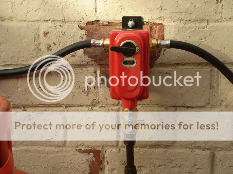

Something like this Opti.....
http://www.gasequipmentdirect.co.uk/Store/Product/MB2C-12-TP.aspx
Seems to be a good price too......looking at the reviews on it... :-\
Taxi_Driver
Re: Gas fire problem
« Reply #16 on: 25 September 2011, 19:18:19 »
PS. Your current regulator looks as old as my 30yo central heating boiler, which got condemned this week  ;D (Still works but got a leaking heat exchanger which is an obsolete part)

Thanks for the link Taxi Driver. It is much appreciated. It looks like it is a simple DIY job, too. We have lived at our present address for 7 years and it has not been changed in that time, so our regulator may well be as old as the hills. :y

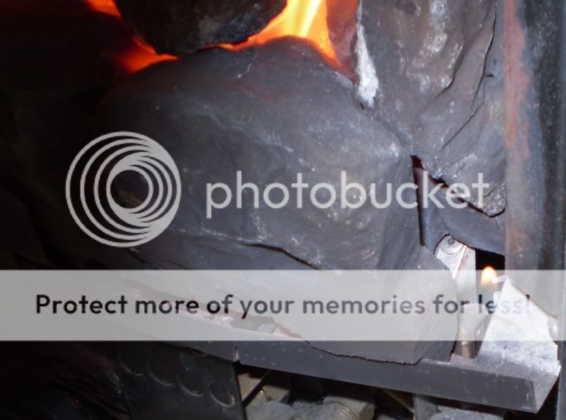

I've just fitted my new regulator, but still have exactly the same problem. The gas fire just shuts down (clicks off) for no apparent reason.
I've noticed that the pilot flame is pretty small. I'm wondering if the fire detects (wrongly) that the pilot light has gone out, and consequently shuts the gas off.
Any ideas chaps?  :y :y

That looks like a thermocouple just touching the pilot light flame. Its' job is to hold the gas valve open unless the pilot flame goes out in which case the valve springs shut.
My guess is that either the thermocouple or the calve it connects to is defective.
Shame you've replaced the regulator for nothing. >:(
I would agree, flame failure device faulty, although just a guess.
Maybe better getting it serviced and flu checked as well?
The original regulator was older than Moses, so replaced (£33) as a precaution. Is this thermocouple Johnnie easy and inexpensive to replace?
