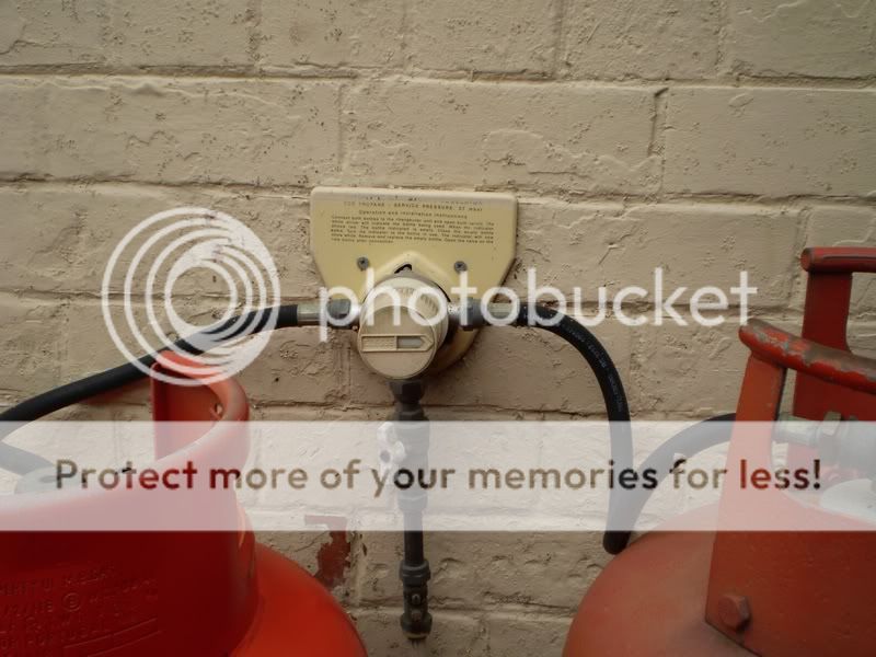

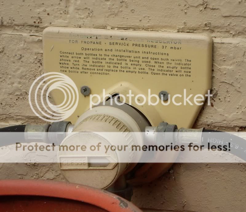

Here is a picture of our current regulator. It services 2 x 47kg propane bottles. I can't see another one exactly like it on Ebay or the internet in general.
Any ideas which regulator would be suitable to replace it, Chaps?  :y
