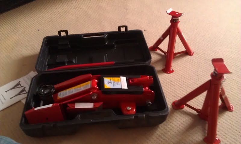

Few years ago when I was a little younger and a little dumber I went and bought these thinking they would be ok for working under Omegas, well, I initially bought these to change pads and recently started thinking about doing oil/filter changes and fighting with exhaust bolts! I actually asked the opinions of 'enthusiast mechanics' on another forum and they said its fine!
So recently I learn that these death traps have been known to collapse, one on this forum and when searching on google I found this:
So needless to say what I will be doing with them. Should I also bin the jack?
What shall I replace this lovely bit of kit with? As cheap as possible without killing me please. Something like this from machinemart ok?

I bought a trolley jack like that in the early 70's. I think it cost me £22. A fortune then. It has served me well since but whilst it lifts the car I think the seals have gone as it won't stay up. The key thing is they aren't(in my opinion) for supporting your car. I always like two supports e.g. blocks under the suspension on the corner you are working on plus a wheel under the cill chocked with suitable piece of wood. I used to have some axle stands but never thought they were safe( you have to have solid ground not tarmac or dirt) so gave them away.

Get some ratcheting ones, they're far more useful than the old peg-and-hole type.

Yep, I've heard from several sources that those riveted axle stands are a liability. :o
Jack should be OK though. You won't be relying on it as the only support after all.

i would never trust that type tbh. all welded ones for me. :y

I'll keep the jack for the time being. Are the Clarke ratchet stands I linked in the first post ok?

Jack is just for lifting, so as long as it's supported on good stands it should be ok. Certainly good to keep for emergencies. Ref stands, I don't like the ratcheted ones at all. I find the clarke ones don't hold the chassis rails well.
