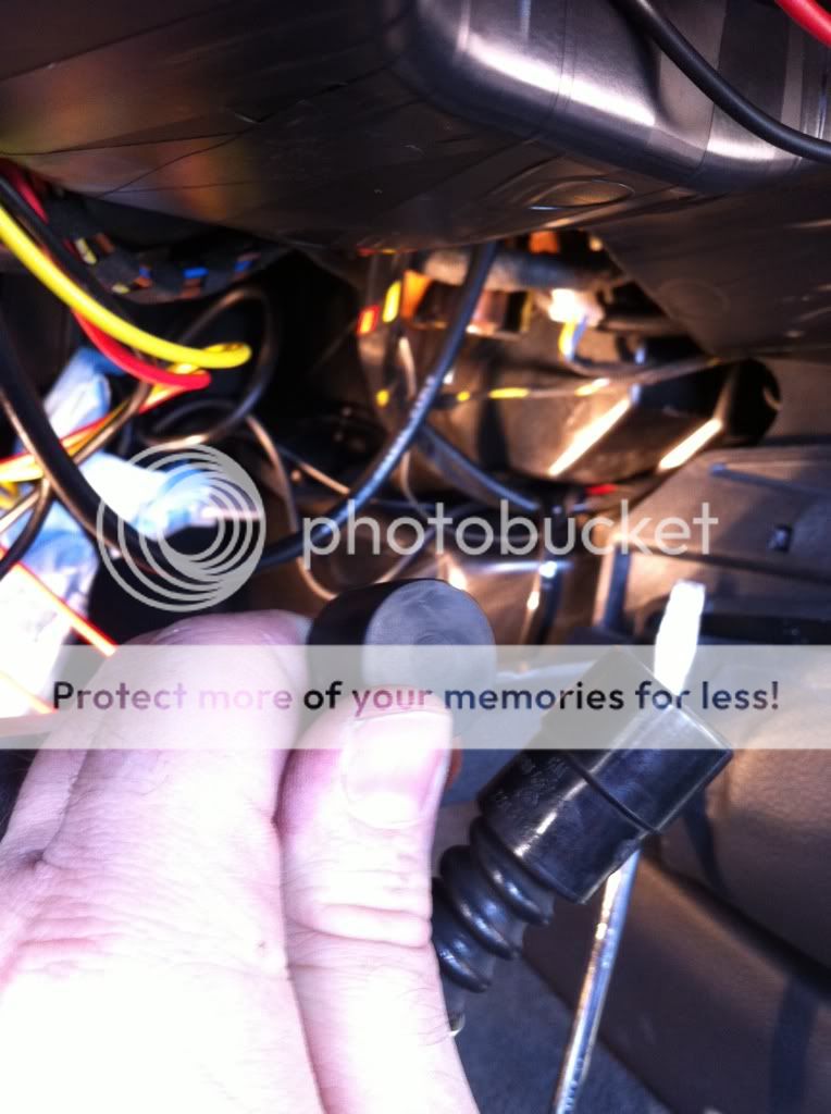

Now locate the ac feed pipe Vauxhall have provided, top right of foot well, rear of centre console, above the footwell vent. Screw driver in the back ground shows general location. Your looking to remove the rubber cap shown in hand. A coat hanger wire with a hook bent over on the and helps here, and fit the end of the feed pipe in its place. Fiddly this bit, unsighted, feel your way. There is a bit of moulding partially obscuring line of site, but it does go on.
More detailed closer pic of the outlet with cap removed.screw driver shows exact location.

Once fitted leave the vent pipe hanging over the BACK of the lower bar running across the footwell or the glove box won't go back in. Now re fit the glove box, connect the electrical plugs and offer the box into position. You'll see the newly fitted pipe fouls the glove box, lift the pipe up out the way to clear and slide the glove box into position.
Once the screws are in and glove box is securely in place, reach under and connect the new pipe to the nipple on the vent previously fitted. It just pushes on. Re fit the rest of the surrounding glove box gubbins. That's it job done.
