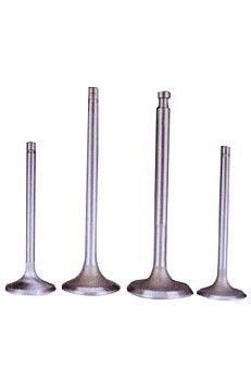

''Poppet'' valve the most common type of valve...
The seat (the bit that is angled from the stem) is machined to an angle between 30o and 45o so they fit or ''seat'' nicely into the head so it seals. the valve seat in the head is angled slightly more to allow for expansion.... gets hot in that there combustion chamber  :y
Exhaust valves are smaller than the inlets and I believe (although I don't have the exact explanation written down weirdly) it's something to do with the exhaust temperature. Maybe someone could clarify?  :)
So to break down the components of the valve....
the valve itself obviously has a valve tip, the spring fixing (where those little collets sit and keep the spring in place), the valve stem, the valve head (where the stem starts to angle, the seating which has the 30-45o angle to fit in to the head nicely and the face which i think is the flat bottom.
another reason why the valve must seat correctly and securely is because the combustion chamber needs to be able to dissipate the heat it creates. if the seating is too shallow or doesnt fit correctly you will get burned out valves.... expensive to replace i imagine!
finally on valves you have the spring which the collar goes over, compress that down, fit the collets, release compressor=one nicely fitted valve  :y

Also valve seat angles, most if not all modern engines will have multiple angles ground onto the seat to support better gas flow.
Exhaust valve size is a compromise, you only have a limited space available within the combustion chamber for valves and its harder to get air/fuel in than exhaust gases out (exhaust gases are expanding as the exhaust valve opens before BDC so they force themselves out plus the piston will push them out as it rises on the exhaust stroke) so they can be made smaller so you can make the inlets bigger (as on a NA vehicle the inlet will be at a vaccum) which is where you want the biggest valves you can get
