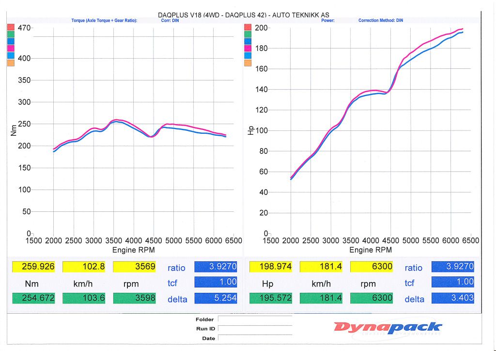

Ran my omega on a dyno today on the Wheel hubs
Got 195,5 hp @6300 and 254,6 nm @3598
Noticed that it fell at 4300, is there any way to improve this fall? (I'm porting a reconditioned engine, witch i will put in by spring, and then take a dyno run again)
Is there anything i can do to that engine to improve the curve?
Anyone here who has had a dyno run on their omega?

(The engine itself has low compression on one cylinder, it uses oil and it throws up much oil into the inlet if i'm sideways driving) witch is why i have a reconditioned engine im working on
But the engine has been chipped, fitted headers, removed the cats and fitted 4 bar fuel pressure
Hmmm, wonder if there's a multi ram issue?
I'm not sure, but it looses power at 4300 rpm and shoots off at 4500

Here is the graph, the upper line (yellow numbers) is with the lights and fan turned off, the lower line (green numbers) are with lights and fan on.

Without seeing the AFR it's difficult to say what that dip is. ISTR that the standard plots for the engine had a similar shaped curve, with a bit of a dip around there, but that must be quite noticeable on the road. :-\
Looking at the curves, you can see a smaller dip at around 2600, and another at 3300. These are probably resonances in the intake and exhaust system, and it makes me wonder if the one at 4500 is a particularly bad example of this. Perhaps a combination of intake and exhaust resonance.  The spacing almost fits.
It might be possible to tune some of this out with a mappable ECU or tweaking the cam timing, but then again, it may be that the intake / exhaust system has a length that's not working well at that speed. Often you've got to put up with this sort of issue on a tuned engine, but given that it's not running more than standard power, I'd be inclined to put it back to the standard setup and see what happens, as something you've changed has made matters worse IMHO.
  • Posts: 36512
Re: Dyno run
« Reply #13 on: 21 October 2012, 11:00:32 »
It's also interesting to see how much difference loading the alternator has made, especially at high RPM. Guessing it's really inefficient at high speeds, or that engine was still hot from the previous run and didn't quite make as much power.

I'd say there is something not working in the multiram department there.
They do have a "take-off" at 4500 rpm, but it's only really noticeable if you go looking for it. It's so small that it isn't really there if you don't.
the exhaust manifolds could cost you something if they're poorly designed. The standard ones are non-interference, which means that they're specifically designed not to give any shock-wave tuning at all. After-market manifolds could give some tuning at some revs, but equally less at others.
What about WOT lambda ? could your high-rev performance be due to lambda inactivity, whilst the low-rev performance is hampered by the fuel pressure regulator - I think we all agree that that's a dreadful idea and should be thrown over the nearest hedge.
