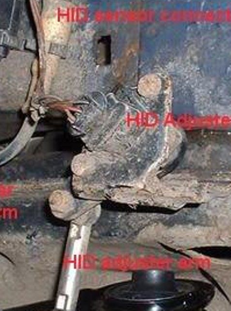

I am looking to sort the xenon headlight message and have read lots of posts about the adjuster on the front suspension.
I'm not sure what the silver arm should be attached to? Has anyone a pic of the working article?
Thanks

Here's one picture.

And another
It looks to me as though the arm has dropped off your sensor.

I have a bit missing then. Probably have to find a second hand one - ebay here we come.

You need a new sensor in essence :y

« Reply #7 on: 25 November 2012, 18:54:15 »
Worth checking in the 'for sale' section to see if anyone is breaking a car with xenons.

you need this part

Check the sales section... There will definitely be someone with a breaker and a working level sensor :y
Incidentally, I think they are the same front and rear but mounted on different brackets :-\

That listing has ended but you wanted the one in the background of that picture :y
But look here first... They seemed expensive to me :-\
