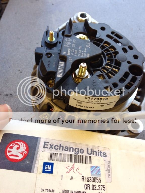

« Reply #8 on: 16 March 2013, 12:52:52 »
Pic below.
Re: Alternator
« Reply #9 on: 16 March 2013, 12:55:15 »
The problem has been that number has not given the part pictured historically. This part was sourced from another dealer. NOT Luton.
Check the part looks like the one pictured.
