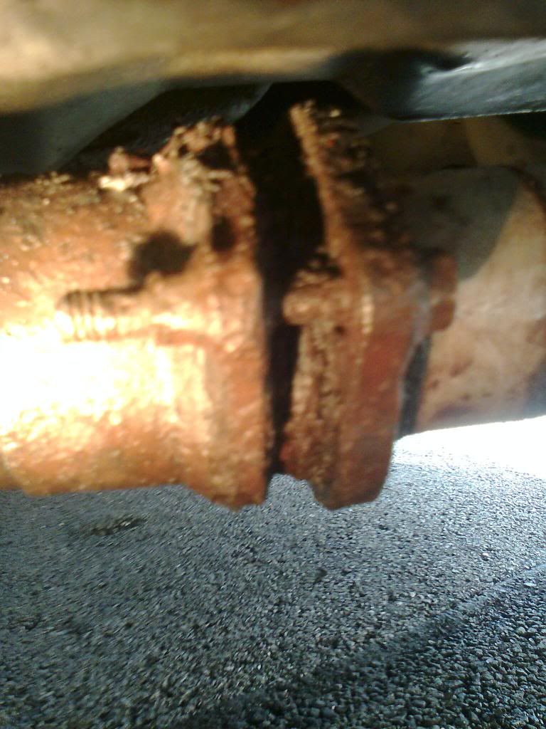

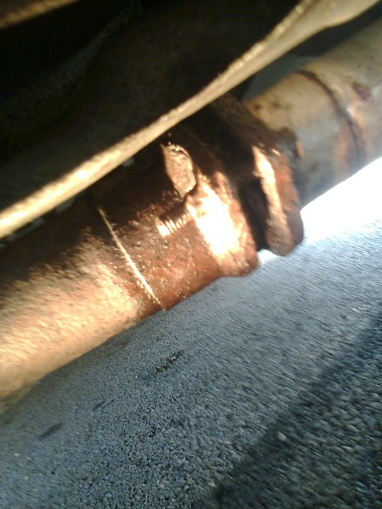

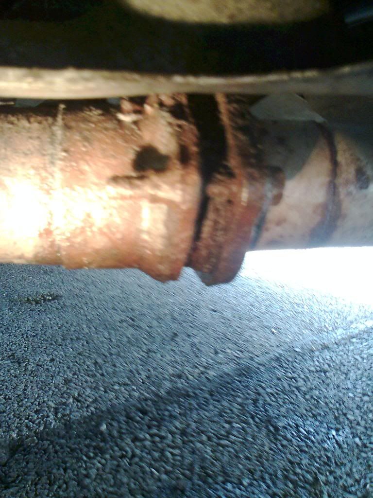

Thanks very much for your help and advice/tips etc......but I am going to give it best. I'll sweet talk the son in law. It has to go to him for a bit of work prior to MOT, which can't be done before the 12th. I have a 2.6 cat here and the joining bracket is built like a brick outhouse. The 2.5 is like a piece of tissue against that. If I drill it out, I'll also have to saw off the threaded extension of the cat bracket, so a new nut would butt up. The new bolts are thicker than the existing, so the bracket would have to be drilled out too.
Pics show what I mean...............

« Reply #88 on: 06 April 2013, 17:55:38 »
That looks a bit odd to me, almost as if someone has already drilled out the screw threads and fitted nuts & bolts :-\
