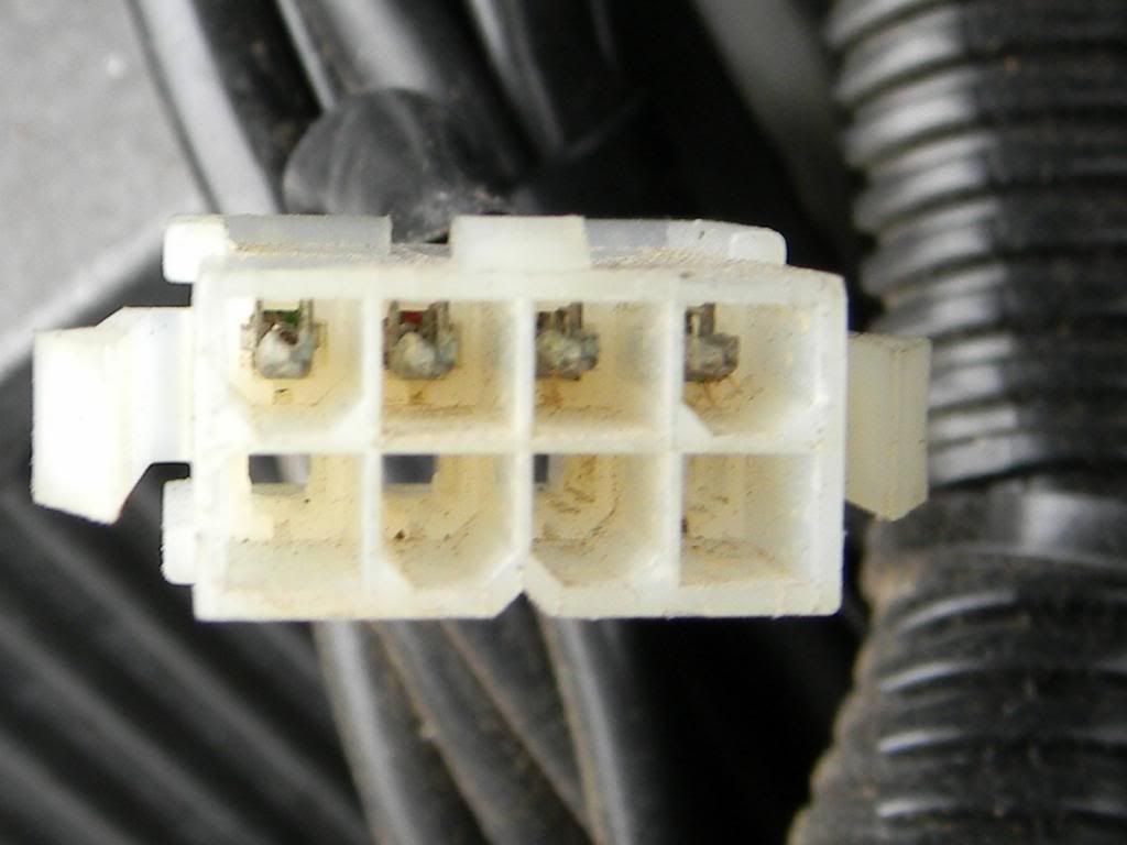

That ecu plug is different to the connector on my ecu,, i am getting a bad feeling about this set up. :'(
Take a picture of the plug before we go any further... I dare say my (and any of them actually) Stag lead may fit ;) I think KME is an AEB based system so might be able to get basic access to it with another software programme.

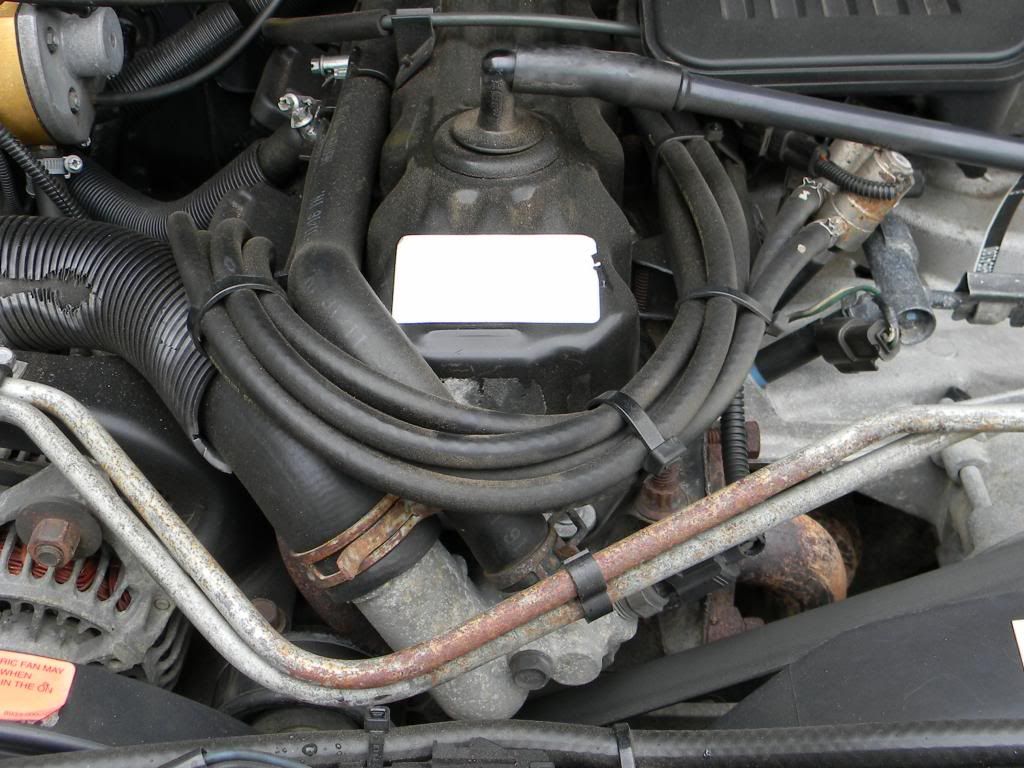

Hi again, here are  some photograghs of the lpg setup on my Jeep.[][/img]
[][/img]
