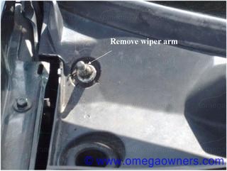

Remove the wiper arms using a 13mm socket.

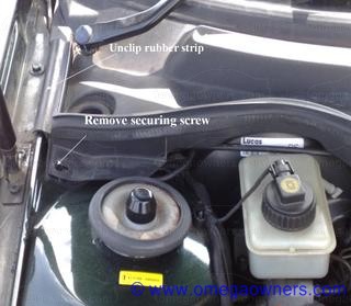

Remove the star shaped screw holding the plastic scuttle panel on the left hand side of the engine bay. Remove the rubber that runs across the front edge of the scuttle.

Remove retaining screw on scuttle cover and unclip small rubber seal.

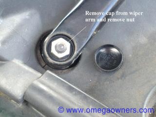

Prise off the cap on the wiper arm to reveal locking nut. Remove locking nut and remove wiper arm noting the position of the arm on the spline. If the arm is tight to remove you may have to resort to using a small pair of pulley drawers and carefully remove the arm.

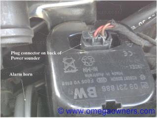

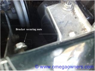

Once you have got this far it is possible to lift the scuttle cover enough to see the power sounder and alarm horn. The power sounder is secured to a bracket which in turn is secured to the suspension post cover. If the Powersounder plug connector is at the bottom of the unit, it may be easier to remove the bracket with the Powersounder still attatched.
After removing the two nuts holding the bracket it should be now possible to tip the unit to reveal the connector.
You can now unplug and remove the Powersounder. If you didn`t follow the correct battery removal procedure first, you will now be left with a siren going off for the next 5 minutes, but it will eventually stop.

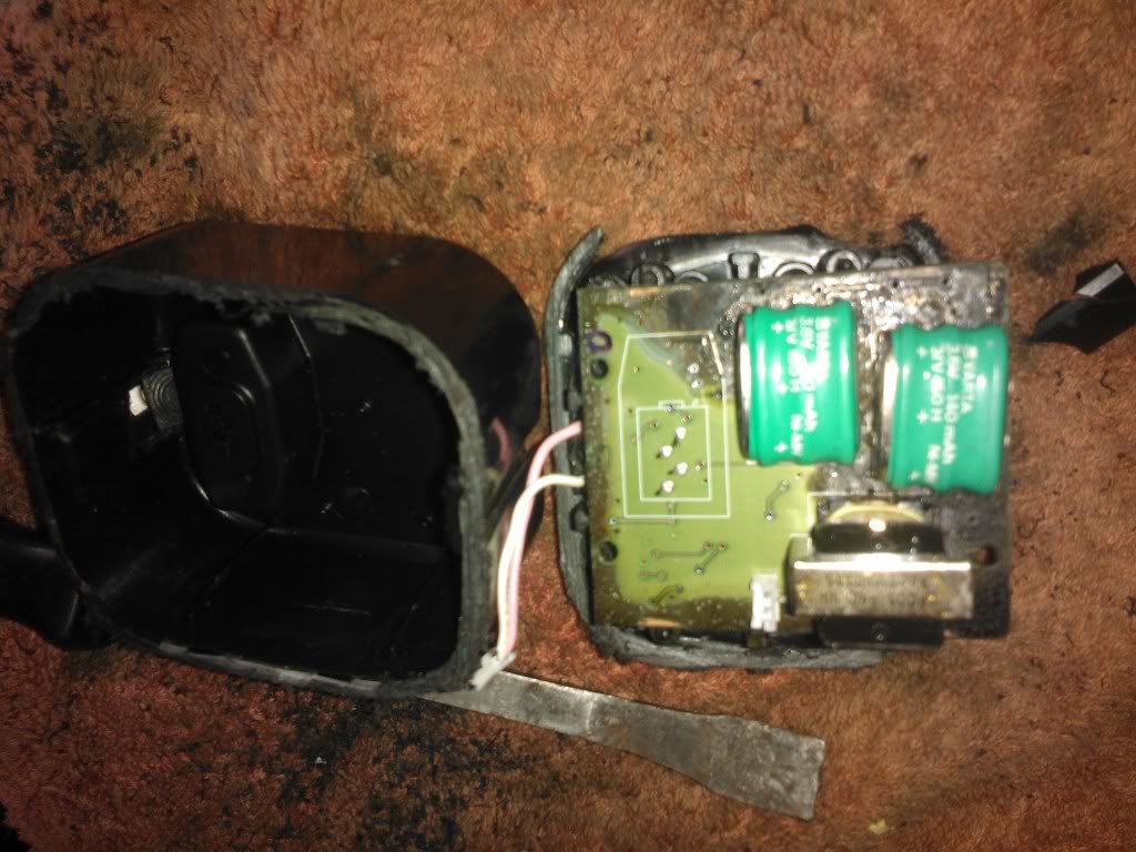

So what causes the Powersounder to fail?
99.9% of the Powersounder problems are down to the internal rechargeable batteries. As with any other rechargeable battery, they have a finite life span, and do not last forever. In an ideal world, these small rechargeable batteries are kept fully charged due to their connection across a healthy main vehicle battery and will therefore give many years of reliable service.
However, the reality is that due to the constant bad weather, low temperatures and price of fuel, many of us are making much shorter journeys these days, and leaving the vehicle parked up for long periods of time. This does means that our main vehicle battery is no longer in a healthy state of charge. This can also cause the internal “plates” of a battery to buckle and fail and not hold their charge.
This also has a knock on effect to the small rechargeable batteries inside the Powersounder, as they too, are no longer kept fully charged. They do not take much to charge them back up again, but this is where the problems start. As the batteries go from low voltage to fully charged on a continuous cycle, they shrink and contract with low charge and swell and heat up with a rapid charge. This constant physical change causes the seams of the battery to fatigue and eventually rupture, and when it does, it leaks electrolyte and acid all over the internal circuitry, causing a major failure and in some instances, combustion – that’s “Fire” to you and me.
The question that will undoubtedly be asked, will be, can it be repaired? and if it’s the internal batteries that have gone, can they be replaced? Well, all I can say is that, whilst replacement batteries are readily available from some high street electrical component stores, most of them floating about seem to be the poor quality China products we are being overloaded with, and I`m not so sure that they offer a reliable solution. That is of course, if the internals of your Powersounder are not completely corroded from the acid leakage. If the insides look corroded like this, then I`m afraid its dead.

As stated, it is not uncommon for the Powersounder to chirp, beep or sound every once in a while, or if the battery voltage is low. But if its happening very often, and it gets to a stage where you can start to “predict” that its going to make a noise, then its time to take drastic action. Do not put it off, because if you do, then the batteries may leak, and the Powersounder will become a dead short circuit across your Main Battery terminals, which will sadly end like this.
Luckily this one was caught and extinguished quickly, but this fault has indeed claimed many members cars on here.
