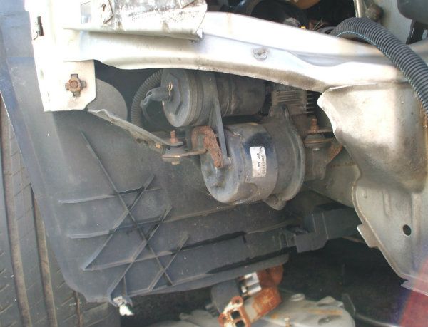

I want to disconnect the pump for my self levelling suspension as the shocks are knackered and I'm going to replace with standard shocks.
Anyone got pics of one in situe so I know when I am looking?

It's the only thing under the offside front wing/bumper  :y It has its own fuse though - just pull the fuse.  ;)
(I'm sure Rob has a picture though .......  ::))

change springs too mate :y self dump has softer springs  :y

Oi,thats my pic ! I was just about to post it when I noticed you already had. :P ;D
