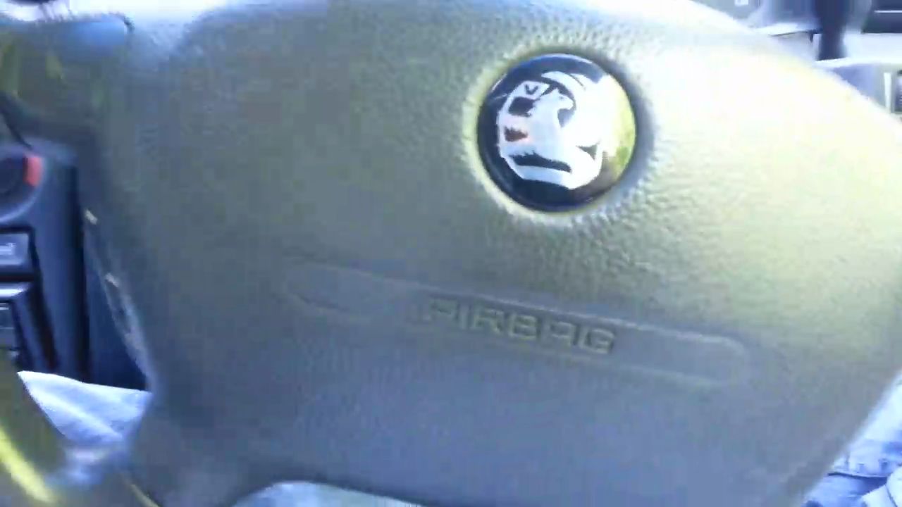

Right i have been out in the car today and have taken a video of the steering you can hear the noise. Its rather strange. Does anyone know what it is? ??? Only does it when turning left. Hope the video works if not will upload to youtube and post link  :y

not working on my pc just see a pic and when i click on pic wont play video. will upload to you tube now.

Works fine here Danny.  :y
