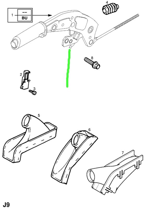

For the hand brake light, the switch is inside the car, buried under the centre console. Think it is mounted beneath the hand brake lever :y
Clipped into the handbrake assembly

« Reply #5 on: 12 June 2013, 16:14:37 »
So basically clear the surround/cup holder out, unbolt the lever mechanism and lift out :-\
Shouldn't need to lift it too far to check the plug, and probably easier if the hand brake is off so that there's no tension in the cable :y

« Reply #6 on: 12 June 2013, 16:16:15 »
Yep, gives enough access

« Reply #9 on: 12 June 2013, 22:18:21 »
:y :y i will have a go at it in the morning...ive already had the handbrake surround off whats left of it.."bl**dy police" wires galore..
so are we thinking its the switch and the handbrake..? as the light is working..? any other thoughts on the emissions light..?
