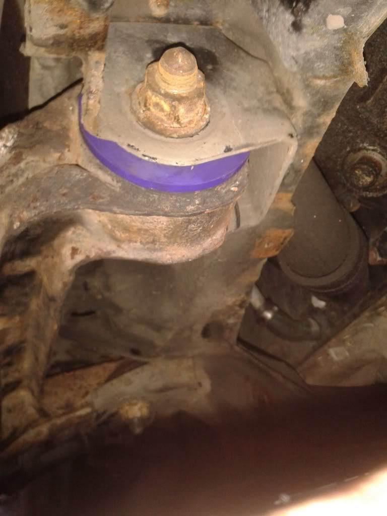

« Reply #10 on: 03 August 2013, 14:03:47 »
IMG]http://i217.photobucket.com/albums/cc134/conalnugent/20130716_195104.jpg[/IMG]Just to update.  Got bushes and all in. The big ones were a pain but nothing a vice, a press, hack saw, fire and a hammer didnt sort out

« Reply #11 on: 03 August 2013, 14:06:22 »
Wow them images are huge. Just to say the poly bushes are a good job and easy fitted. There split in the middle so just slide in either side by hand. Would recommend them to anyone that needs to change them
