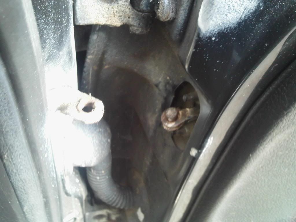

my new lady friend has a pug 206. nice car. used to working on them too due to there being 2 in the workshop. however her drivers door swings all the way open. I looked at the door strap and its not connected as per the following photo. I cant work out whether the strap has disappeared in to the door or whether it actually is broken off. any ideas? :)
ps, the piece pn the right coming out of the door moves up and down but wont move at all towards the body.

oh yes t should pull out towards A post--pin has pulled out of bracket on A post-needs pin removing and new pin or nut/bolt fitting :y
And they will need a lot of force to pull back out.

so should I be pulling the strap out of the door with plenty of force.... then undoing where it connects in the door. then replace with new strap? :)

Quote from: Webby the Bear on 12 August 2013, 11:44:53
lol cheers guys.
or replace that F*****D pin-whichever is easier  :y :y
