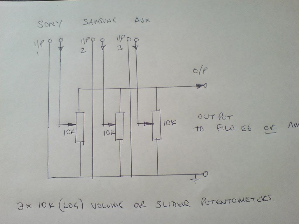

You could make up a very simple and cheap Passive Mixer to fed to Filo or MP3 Amp in, that way you could pre set the input level from each devise separately.
I draw something and post it in a minuet. Chris.   ;)

« Reply #6 on: 18 August 2013, 14:37:52 »
Something like this, 3 x 10K Volume Pots or sliders (Logarithmic), this way the output impedance should be fairly constant.

Thanks Chris,
                      seems simple enough. But  I could be totally wrong here , that sketch looks like mono . Is it just the case of converting the  stereo lead from the device (stereo . . .2 x  hot tips  & 2 commons to a mono plug with the 2 hots linked to the one hot tip of a mono plug ?
Presume it will be 3.5 stereo plugs in & out from the FiiO as well
Also which tag on the pots  . . thinking theres usually 3 ?  or are these all linked  & any one will do ?  :-\ :-\ :-\

Yep, mono, is your Amp stereo?, if so just double up with Dual Gang Pots or Sliders (Sliders can go noisy after a while due to the crap that can get in them), being Logarithmic you need to wire them correctly, as you say 3 pins per channel, the sliders are normally marked which one needs to go to ground, the Pots with 3 pins work as per Volume control so as you look down on it from the front, left would be ground, centre i/p and right o/p ie clockwise, if that makes sense..
If your amp is mono, which I suspect it is, then just short Left and Right on all the inputs jacks.  ;)
On the level side just put your devices on near full volume and let the mixer do the rest. ;)
