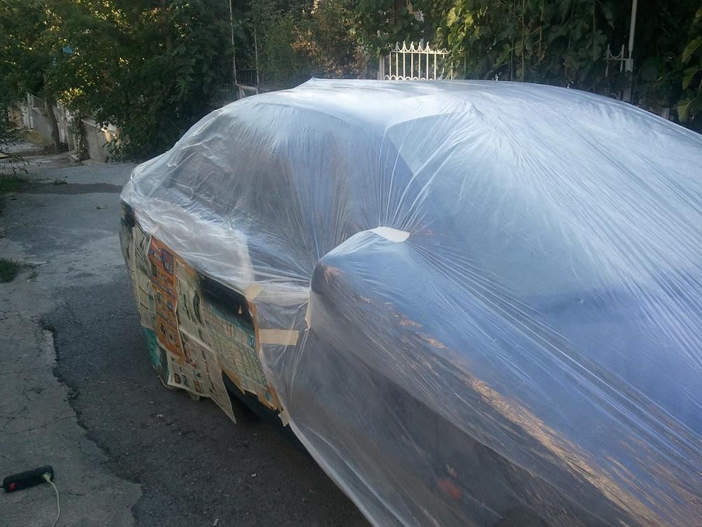

and here is the plastic film to cover stone chips
You can get ready made bonnet bibs , i think they are made of leather  :-\
Quote from: Emd on 30 September 2013, 22:16:48
there are .. but I dont like them :-\

I had to paint it if I didnt cover up ;D :P
