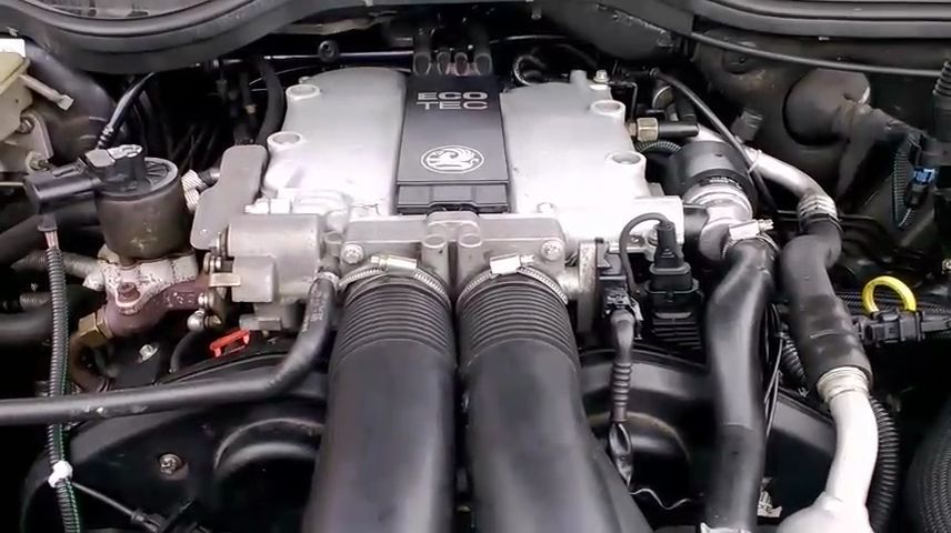

Well. it runs beautifully!!!! martin, perhaps you'd post that video for me? :) ps, thanks so much for all your time and effort. I get some dollar next week so expect me at your door with a thank you present or two ;)
the lifters are quiet as anything!!!!
the exhaust pipe to back box has a blow so need new pipe and I need to get a battery hold down as I lost my plate bit. (can anyone recommend an easy battery hold down just to get through a mot?)
check enine lights on with codes for crank, cam and knock sensor. however im thinking they're old codes from the previous explosion. so battery disconnected for a couple of hours to reset those.
very happy. shes gorgeous to drive!!!!

If the engine light is on you have a current fault code that needs sorting
  • Posts: 34115
Re: Omega. Officially back together
« Reply #26 on: 19 October 2013, 20:31:22 »
Oh yes, the battery off trick does not work on these more modern ECUs
« Reply #27 on: 19 October 2013, 20:40:13 »
Connecting the Maf does though  ;D
Interesting: we read the codes via the pedal trick. They suggest knock sensor, cam sensor and crank sensor. Surely these are the stored codes from the timing belt snapping.... cam ad crank cos obviously it didn't have a reference point when the pistons decided to meet the valves... and the knock sensor as at the same time that got destroyed somehow????
TB, do you have your TechII still? if so any chance of me popping over for an ECU interrogation?  :)
RIP Paul Lovejoy

Ps, Martin, thanks for posting the vid. Any chance you could put up the vid of the codes?
From memory I make it code 18 (knock sensor), code 94 (Hall Sensor.... presumably crank sensor) and I cant remember the other one  :-\
