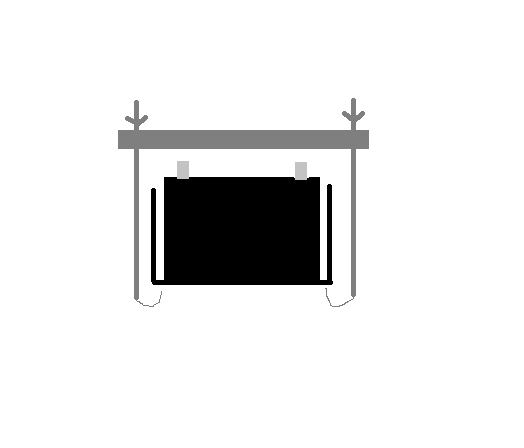

Hi guys,
Is this how to fit one of these.....
http://www.halfords.com/webapp/wcs/stores/servlet/product_storeId_10001_catalogId_10151_productId_225569_langId_-1_categoryId_255205#tab4
..... to my Omega's battery to get it through the MOT......

Yep, the original one just needs a single bolt in the centre of the battery. To fit that one, you'll need to hack some extra holes in the inner wing.
As said, what's up with the original? If it's missing, just get someone to send you one from a breaker. :y

I think you might need a hole in the bonnet too to clear the front tie bar  .......  ::) ::) ::) ::)

... In answer too the question re what's up with it...... Lost the plate  ::) and the bolt is stuck in. Il see if mole grips wil get it out  :y
