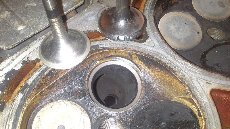

Head is off....!
The culprit:
Removed and good valve fitted and lapped to check the seat:

they look like gauges.... any idea how that's happened? debris in the cylinder?
RIP Paul Lovejoy
  • Posts: 34112
Re: Burnt no 5 valve need help
« Reply #44 on: 16 December 2013, 22:18:11 »
Once you get a point that does not seal, the gas erodes the valve and creates the gouges.
Thankfully the seats are hardened so they get away with it.
