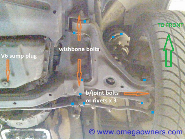

Thanks kev. heres a pic i found and i marked in blue what i need to check. can you just confirm ive got this correct as my suspension knowledge is pretty poor sadly
Yep,check everything that has a bush or a balljoint and you won't go far wrong :y

Yep, what's in your picture plus the anti roll bar bush. Follow the anti-roll bar forward until it turns 90 degrees and heads across the car. Inboard of this point is a rubber bush in which it sits. Can't recall, but you might need to remove the undertray to see it. It's possible this bush has got damaged or dislodged by the impact.

Cheers lads. anyone got a pic of where they are located just so I don't go on a wild goose chase  :-[
