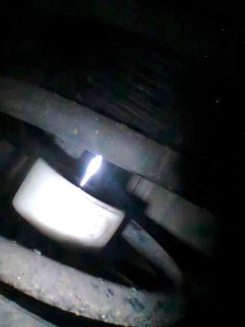

Hi again guys. Thanks for the valuable info. Been out and under the car and this is what I found...
First thing I noticed was the rubber tube at the top of the damper has come up and is exposing the shiny metal underneath and what looks like a white plastic ring. Not the cause of the creaking of course but i'm presuming this rubber boot should cover this.

ps this is how the drivers strut looked whilst it was on axel stands...
Has the boot simply rode up and needs pulling down or will it go back to normal when off the axel stands? :)
Yes, that's normal. Check it when compressed and all will be well.
normal, rubber gaiter will cover the shock at normal ride height
