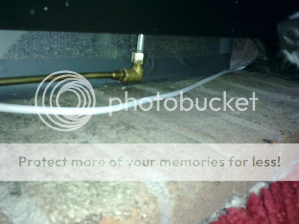

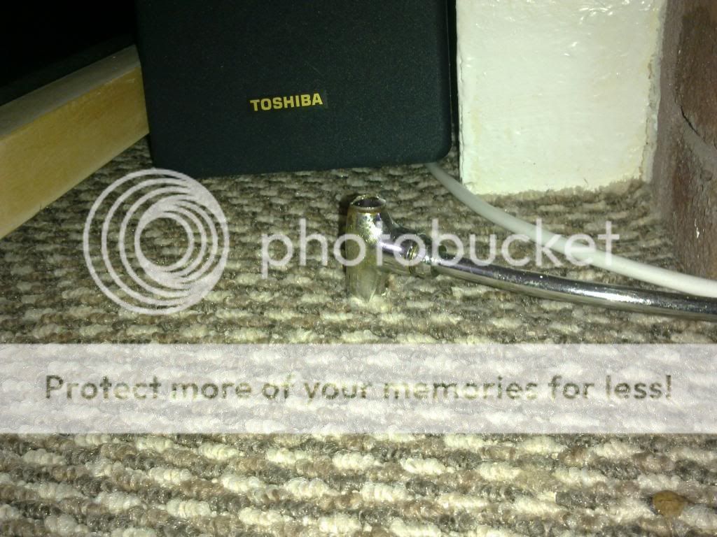

Dear Oofers.
Would it possible to disconnect a gas fire myself or do I need a registered gas fitter?
People online say it's easy but I don't know how to do it.
What advice can you give me?
Here are some pics.

The chrome connection on the carpet is a stop so switch off by turning 90 deg on the top.
This will let you disconnect BUT check for leak with a bit of soapy water it is an old stop
HTH

Isn't the chrome bit a cover to access the actual stop valve?  :-\ It's been a while since I've played with one. And would you want to rely on a stop valve? Best blanked off I'd have thought.

I agree  :y Unscrew the top cover and you will find the valve underneath, just screw it clockwise until it goes tight  :)
I'd turn the valve off when the fire is lit, so it burns off any gas left in the pipe to fire...
You can always get a gas fitter to remove the valve and cap it off at later time..or leave it there, im thinking that you have to put the fire back if you decide to move again...(which you need a gas fitter to do)
