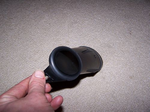

If you want a bit of induction noise/slightly freer airflow, remove the trumpets from inside the airbox...
It's free and doesn't bugger up the MAF sensor :y
What is this exactly? I've never come across it before. Might try this if it doesn't have any negative affects overall, Just adds a little noise.
Should just unscrew from inside the airbox , did it on the vectra but had cold air feed .
Typed it in google, Found this on OOF's old site.. This the part ?
Can't say I've noticed it before tbh..
Take the top off the airbox... will be blindingly obvious  :y

Here is a reality check......the K and N does not flow more air than the stock, thats a fact (and physics) and verified some years ago with back to back comparison on a rolling road. The K and N (and Piper etc) worked great on the old cars with small pancake filters or small panel type filters but the modern units with large surface area, long service interval filters, are a VERY different story.
They still have a place, for those wanting a bit more induction roar, kit cars, engine transplants and stuff that is highly modified and far from stock but, for the standard engine setup....a waste of money (unless you want more noise lol).
As for the trumpet removal, that can reduce airflow (again physics) beleave it or not.
