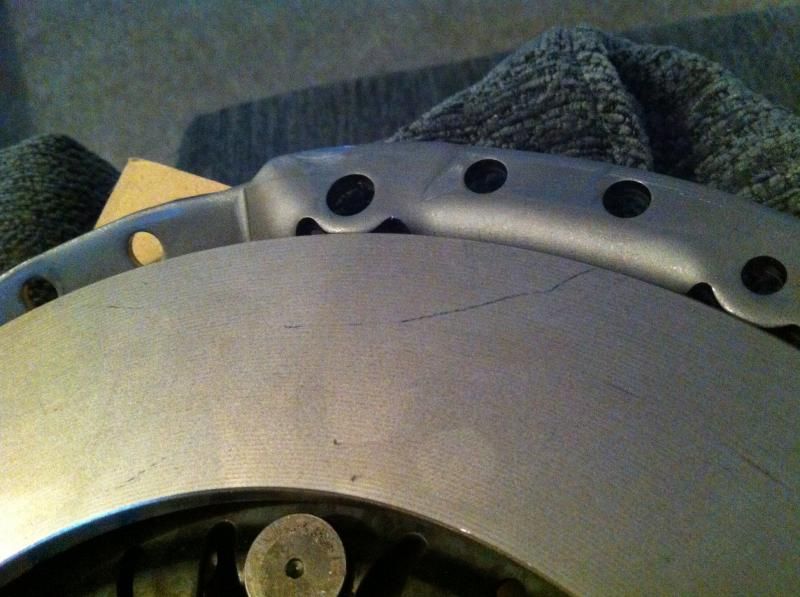

New clutch kit is at home, just inspecting it
Seems to be a scratch, just about detectable by a fingernail, on the pressure plate surface as per pics
Ok to fit? Or likely to damage friction plate?
To get a new one tomorrow would be a massive ballache :(

Should be clean and smooth... send it back :'(
Pic no worky btw...

can't see your picture, but if it's only detectable by finger nail just fit it. Friction plate will soon  make its own marks.  ;)
Pic no worky btw...
I have to disagree  ::) I
In a perfect world, you're correct, but as it's only just detectable etc etc ........ I'd fit it (but I wouldn't have  car with a clutch anyway  ;D)

Fit it  :y

I do not see why it would be a problem. :y

friction plate will sort it soon!

Just need to satisfy myself it's a small scratch, not a crack! Don't want a chunk breaking off!

Neither do I.

If its just a scratch - fit it James, shouldn't cause any issues ;)

And the problem is..

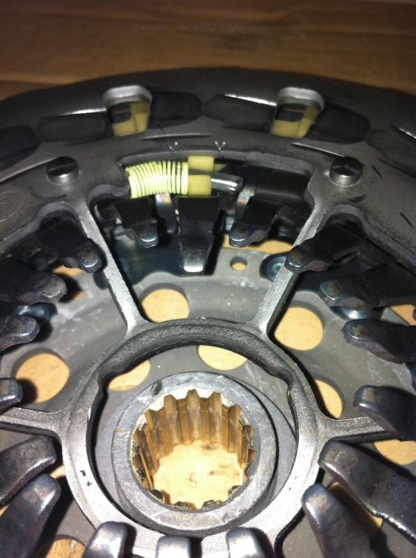

Also re pressure plate
Three of the diaphragm parts on the plate sit much lower than the others. See pic.
Is this normal for a new sac clutch?
The three that are lower are directly under some sort of spring. Guessing part of the adjustment process
Anyone confirm please? I'd like to get this done tomorrow :y
